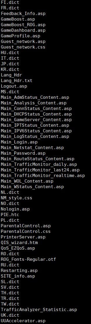

    SSH——“CN.dict”Representative language, replaceable
    mount -o bind /www/CN.dict /www/$(nvram get preferred_lang).dict
    #6282
    AvatarAmorous
    • Replies 13
    I use “Xshell”——ssh
    cd /www
    ls  (View all files in the directory)
    The following 2 websites illustrate the problem
    https://wchan-asus-rog.test.edgekey.net/forum/showthread.php?116703-AX11000-Region-setting-question
    https://www.snbforums.com/threads/australia-not-supported-on-ax11000.60510/
    How to cheat the router?

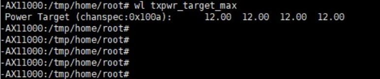

    The answers found from China, the previous code is blocked, the new need to find
    Now change the area, the code is a number
    power Code:wl txpwr_target_max
    UK power:12 12 12 12
    ssh——————————-
    nvram set wl0_country_code=CN
    nvram set wl0_country_rev=947
    nvram commit
    service restart_wireless
    nvram set wl1_country_code=CN
    nvram set wl1_country_rev=947
    nvram commit
    nvram set wl2_country_code=CN
    nvram set wl2_country_rev=947
    nvram commit
    China power: 24 24 24 24
    You will find that the power of your router doubles directly!!!
    947 is China
    The United States and Australia do not know yet.
    Chinese netizens did not tell me, I do not know how to check
    SNBForums,Don’t post this question,Will be warned
    #6601
