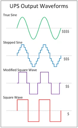

    When an ASUS router is plugged into an UPS, can you advise what waveform the ASUS routers AC adapters supports as ASUS owners often comment that UPS did not stop router powering off during power cut. I know from my xxxxx days that cheap UPS support a different waveform from the more expensive true sine waveform ?
    Thank you in advance .
    • true sine waveform
    • stepped sine waveform
    • modified square waveform
    • square waveform

    So have had feedback from ASUS regarding supported UPS waveforms, ASUS (routers division) have spoken with their various power adapter manufacturers and ….
    ASUS has discussed with their power adapter manufacturers and they (adapter manufacturers) claim the adapter should work with all 4 waveforms.
    • square waveform
    However, there are many manufacturers and some of the older products (adaptors),  ASUS cannot guarantee all work with all 4 waveforms types.
    There is a single concern regarding “Modified Square Wave”, since there is a period of time with ‘0’ Volts, the adapter works or not is dependent on the specification of the UPS and the amount of time the adapter spends at ‘0’ volts.
    However ASUS believe if the time the wave is at ‘0’ volts is only 2-3 msec then there should be no issues.
    So does sound like ….
    Both true sine waveform and stepped sine waveform is a safe option,  modified square waveform is more interesting.
