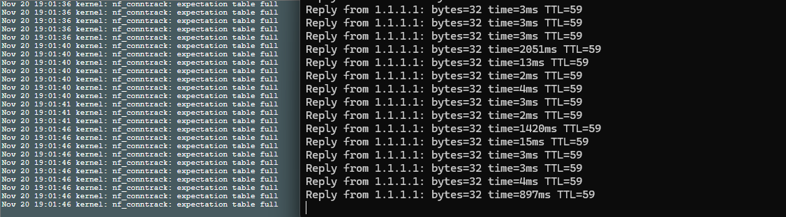

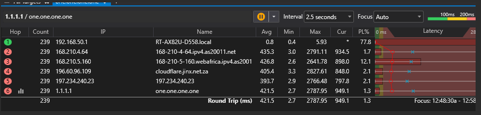

    EDIT : Just adding this screenshot of pingplotter targetting 1.1.1.1
    Seems it is my router just dropping packets
