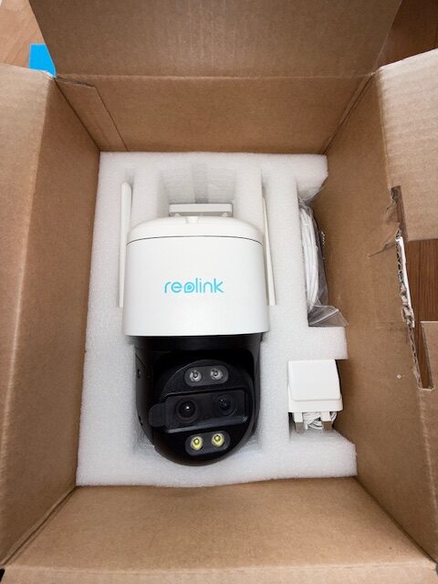

    Reolink TrackMix WiFi in box:

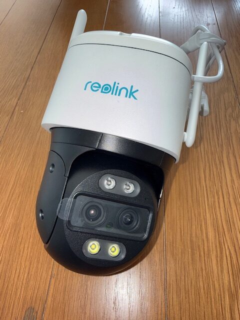

    Reolink TrackMix WiFi front view:

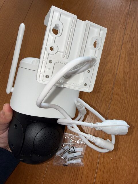

    Reolink TrackMix WiFi side view:
    Reolink TrackMix WiFi rear view:

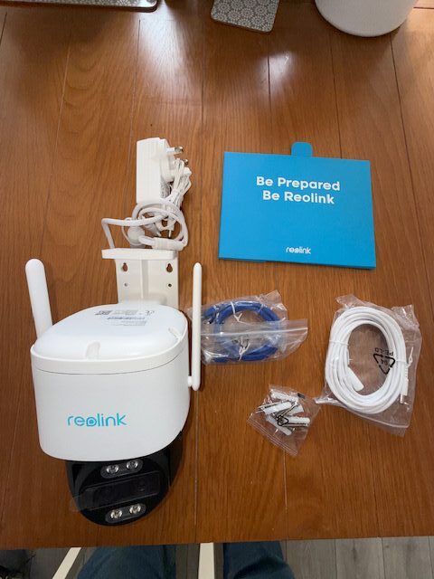

    Reolink TrackMix WiFi whats in the box:

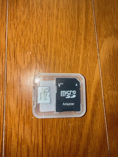

    High Endurance 512GB Micro SD card (purchased separately)
    What’s Included in the Reolink TrackMix WiFi Box
    • Reolink TrackMix WiFi Camera (dual‑lens PTZ, 4K)
    • Power Adapter (included only with WiFi version)
    • 4.5m Power Extension Cable (WiFi version only)
    • Ethernet Cable
    • Mounting Plate / Bracket
    • Screws & Anchors Pack
    • Quick Start Guide / Documentation

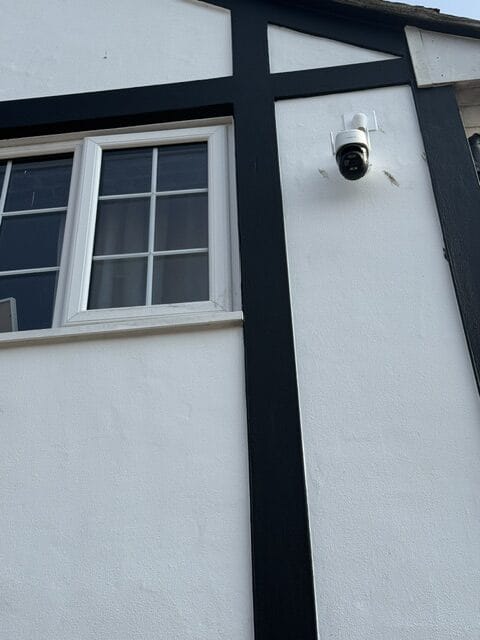

    So finally got around to mounting the Reolink TrackMix WiFi 4K PTZ Wi-Fi 6 Dual-Lens Security Camera and thought I would share a picture.
    The camera is mounted higher than originally planned because I live in a cul-de-sac and my neighbours asked if it could also cover the areas around their properties. Mounting it at a greater height provides the wider field of view needed to achieve this. However, the trade-off is that it is less able to capture faces clearly at eye level.
    Fortunately, a couple of our neighbours, including myself, have smart doorbell cameras. If anything untoward were ever to happen, we could, if necessary, use the footage from these cameras to assist. As they are mounted at eye level, they are also more likely to capture clear facial images than my CCTV camera.

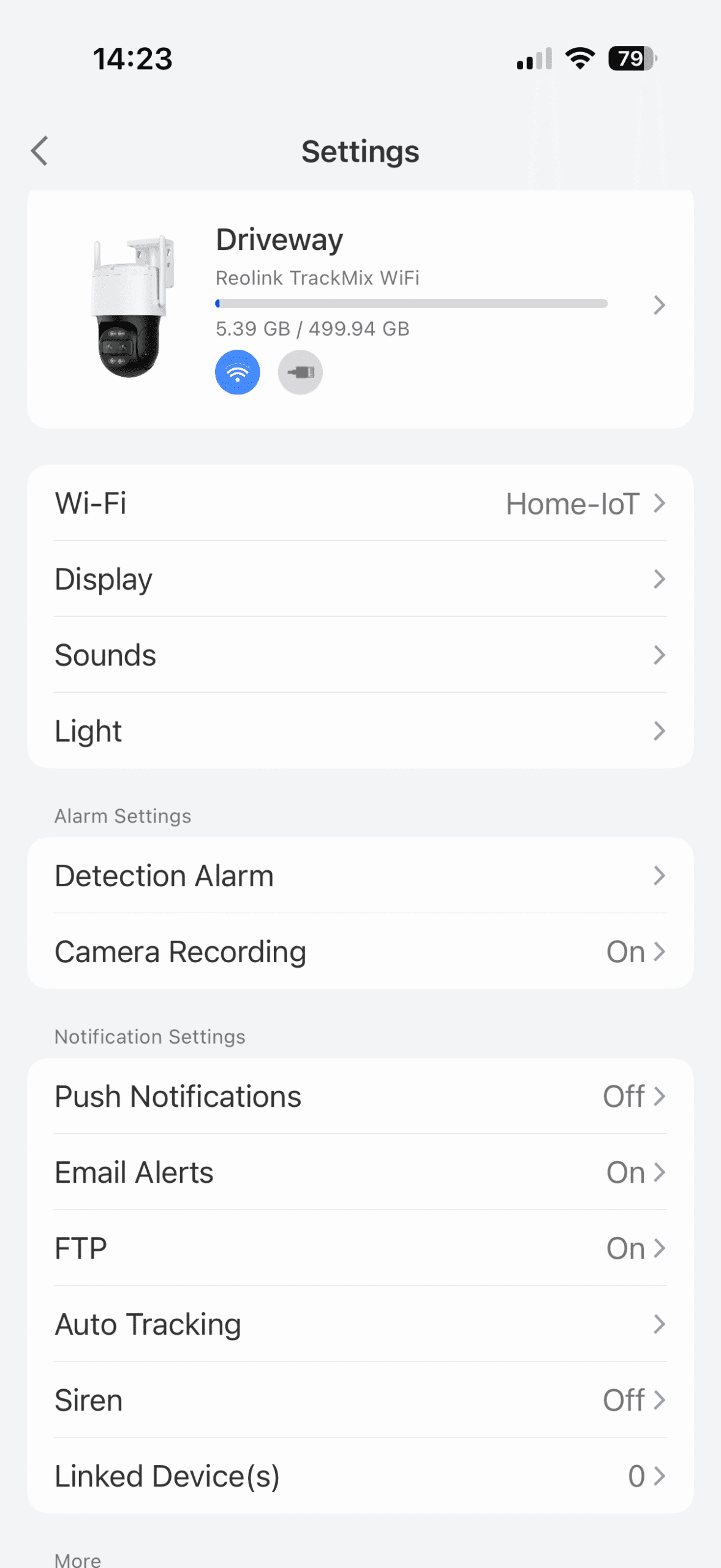

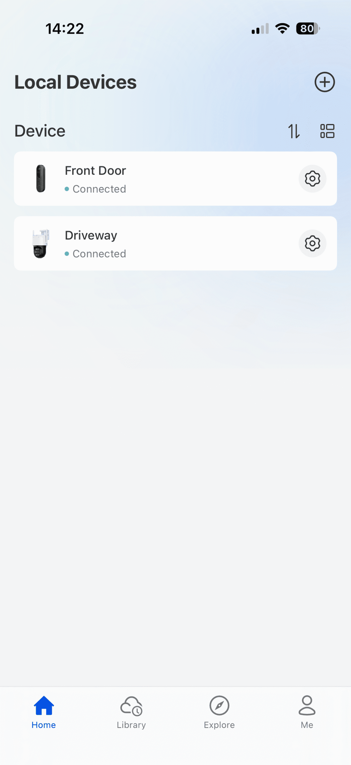

    A couple of images of the Reolink app showing both the Reolink Smart Video Doorbell and Reolink TrackMix WiFi 4K Camera
    Reolink TrackMix WiFi 4K Camera – App View

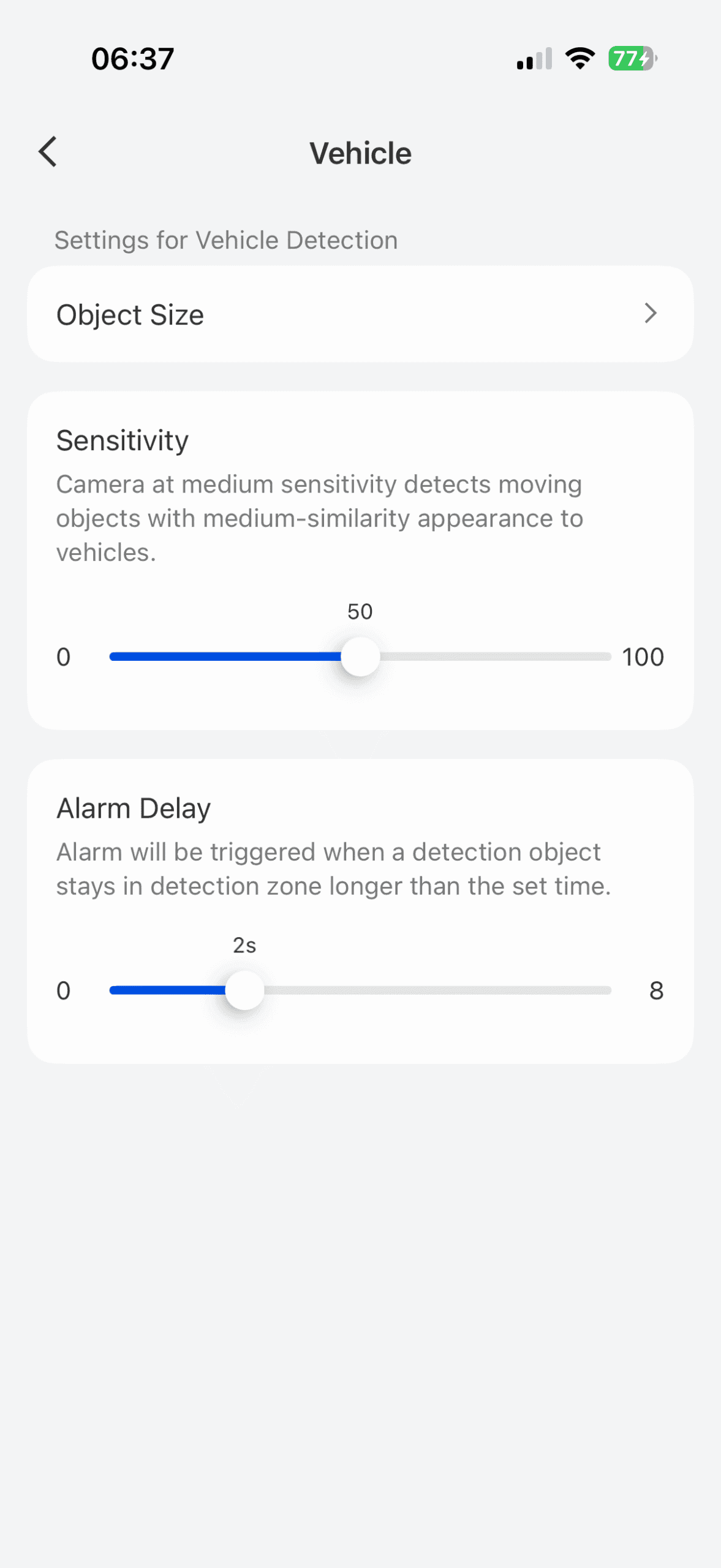

    Update on this as I was getting lots of false alarms at night, especially when it was raining.
    Every time it rained heavily or moths fluttered near the lens, my camera would flag a false event and trip the spotlight. It was constantly mistaking rain over my parked car as a “Vehicle” movement.
    I managed to resolve this by tweaking a setting called Alarm Delay (Settings > Detection Alarm > Alarm Delay).
    By default, the AI reacts instantly and causes false triggers.
    Alarm Delay forces the camera to double-check that a shape is actually there for the nominated time (seconds) before triggering, since rain and insects fly past in a split second, this filters most of them out.
    I changed my Reolink Alarm Delay sliders to:
      • Person: 1 sec
      • Animal: 2 sec
      • Vehicle: 2 sec
    Tested the new settings in pouring rain and it is working well, my 24/7 timeline was completely clean and no false alerts. Definitely give this a go if you’re experiencing the same issues!
