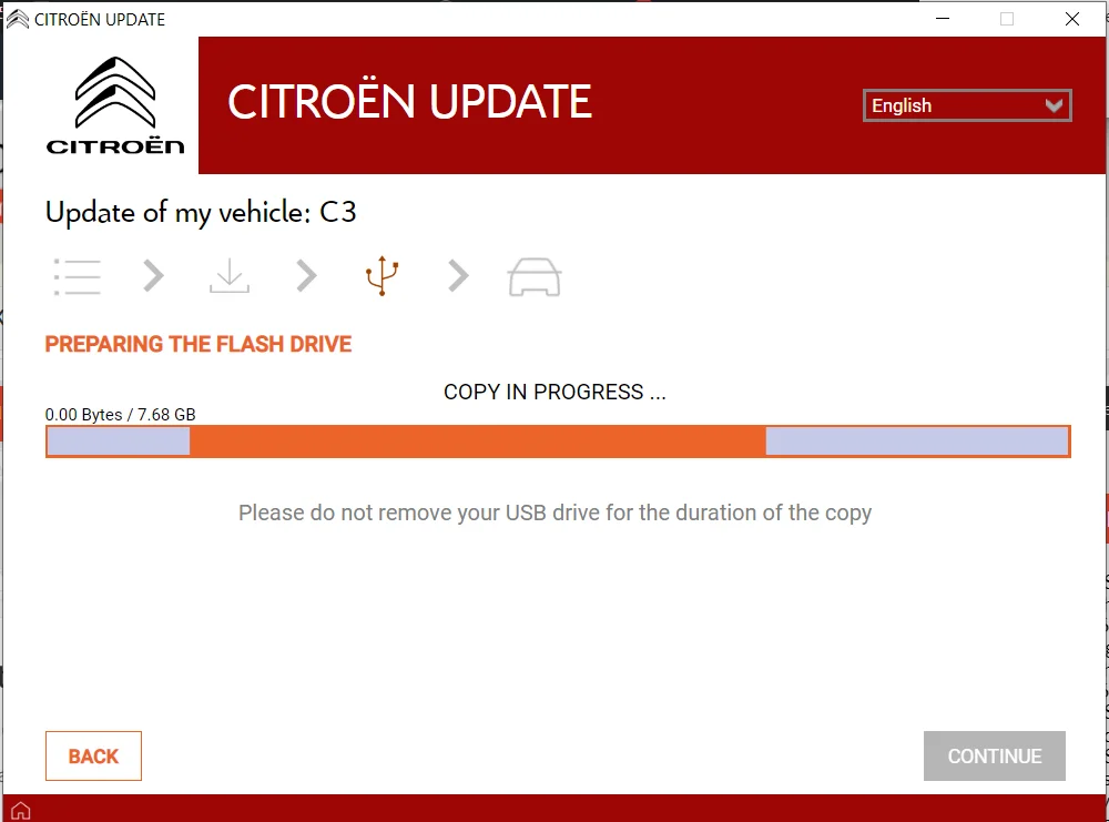

    So I dug out a 16GB USB flash drive (FAT32) and downloaded the two files needed to update to Version  – 5_096_20.0h022.23 07/06/2022
    • license_xxxxxxxxxxxxxxxxxxxx.key
    • rcc_update folder including sub folders after extraction
    Files size was around –  7.68GB and has been copied to USB flash drive
    Now plan to updates Citroen’s Firmware over the weekend and will be following instructions as per attachment below

    So this morning I checked the System software / firmware version of our Citroen C3 which is 063D
    I then started engine and inserted USB stick into the USB slot by Gear Lever and following the onscreen instruction which took about 20 minutes to complete.
    The Citroen C3 is now running system version 069D but have noticed we are now no longer able to activate the MUTE option on the Radio by the Screens control knob which is most ODD and annoying.
    Update:  after leaving Citroen for a couple of hours, Radio Mute button now works
    Pictures below of C3 System firmware updates stages
