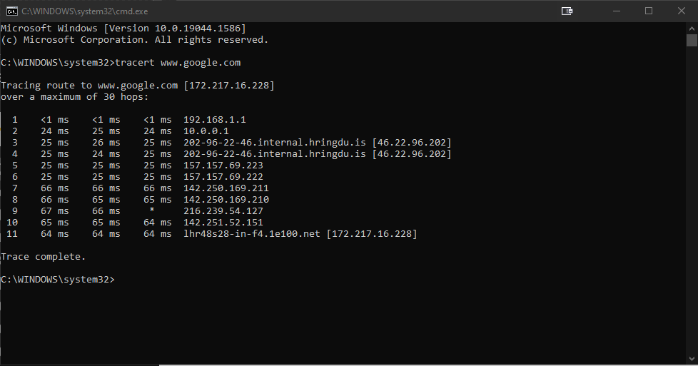

    and also type ‘pathping 1.1.1.1’ and Nslookup and try Google.com if you could ?
    ‘nslookup google.com’

    here is a screen shot
    #18477
    Avatartorment
    • Replies 69
    here it is
    #18479
    Avatartorment
    • Replies 69
    second part

    • Replies 8,745
    and ‘nslookup google.com’ if you could ?
    #18482
    Avatartorment
    • Replies 69
    here it comes

    IP address (maybe DNS) is 1.1.1.1 which is Cloudflare and they do offer parental type controls for Families ?
    Also it is saying on the NSLOOKUP Google.com that the server is called One.One.One.One or tat maybe the DNS resolver ?
    Not sure what is going on with DNS resolver, but I think your issues maybe Cloudflare ?

    no probs mate was just frustrated changed to 8.8.8.8 8but still wont let me in to the forum or reddit or my server
    #18487
    Avatartorment
    • Replies 69
    even that i changed the dns on the router it still showd 1.1.1.1 one.one.one.one
    on the nslookup
    having a melt down

    • Replies 8,745
    What device is 1.1.1.1 on currently for DNS ?
    #18490
    Avatartorment
    • Replies 69
    no one
    #18491
    • Replies 8,745
    what device was 1.1.1.1. On originally ?
    #18492
    Avatartorment
    • Replies 69
    in the draytek
    after rebooting both the switch and the router now nslookup is looking up 8.8.8.8
