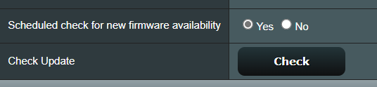

    There are new EULAs to Accept also now there is no way to Disable AutoFW Upgrade.

    Interesting, so the option is missing …  ‘Scheduled check for new firmware availability’
    (Image taken from ASUS RT Router a guide only)

    From the Firmware upgrade tab screen you uploaded it looked like auto upgrade and security both had on – off switches, do they not work?
    I  ask because the retention of the check availability button + beta search switch suggests the only intention is a layout change and therefore that maybe those buttons should work?

    If anybody else has issues with their DSL-AX82U and the Disable AutoFW Upgrade button not working, can you send a Feedback form via the DSL-AX82U UI explaining this issue, I will ask ASUS in the back ground also
