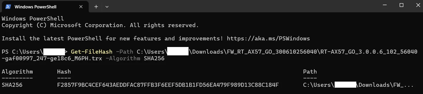

    Hey, did someone check the checksum?
    Mine doesn’t match SHA256: af7dbdc60c1111b24b844ab1dd44a9e6f4c651a63bcb32055704451e4b6c41d7 shown on site.
    I tried many VPNs same result..
    f2857f9bc4cef643aeddfac87ffb3f6eef5db1b1fd56ea479f989d13c88c184f

    What tool are you using to check SHA-256 checksum ?
    Edit: just run Windows PowerShell and must say, I agree checksum SHA256 seems incorrect from ASUS

    I checked ASUS previous firmware release,  ASUS RT-AX57 GO Firmware version 3.0.0.6.102_22250 SHA-256 checksum and this one is correct ?
    SHA256: 78e0f3f15392b9aae44934cfe5824ed39a954e8e0f1d33e86c8b555554d56e0d
    Maybe wise to avoid firmware RT-AX57 Go Firmware version 3.0.0.6.102_56040 if you are not happy

    Yeah, Firmware version 3.0.0.6.102_22250 is fine.
    I am gonna keep my current firmware.
