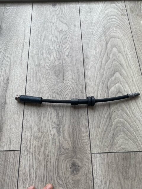

    So I Purchased 2x Fiat 500 front brake hoses form EuroCarParts (ECP) for £20 each and some new DOT 4 brake fluid. (replaced both sides I did).
    New Fiat 500 front brake hose unwrapped.

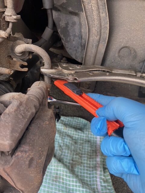

    Then with a set of mole grips (locking pliers) I clamped the brake hose about an inch from the end of the hose and with a knife I cut just below where the mole grips clamped on the brake hose.
    The mole grips stop break fluid leaking and cutting the brake hose allows easier removal of brake hose from brake caliper.

    Picture below of Fiat 500 with new Front brake hose fitted.

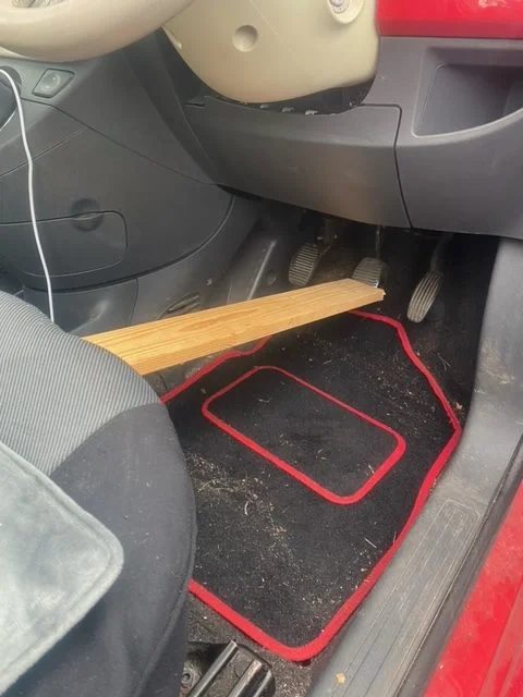

    Picture I forgot to add earlier,
    A handy trick to stop the brake fluid reservoir draining whilst you are working on the brake pipes is to slightly depress the brake pedal (1″ to 2″) and hold in place, this then creates a vacuum in the master cylinder that stops brake fluid draining from the disassembled brake pipe and hose components.
    Safer than clamping as this can damage brake pipe walls etc.
    (car had a good clean after I finished)
