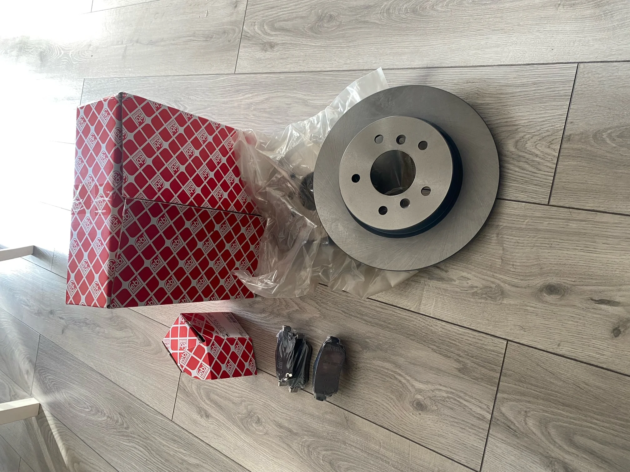

    Doesn’t time fly, finally got around to the decision about Rear Brake Discs and Pads for our Renault Kadjar.
    Found a great offer for a set of Febi Bilstein discs and pads and could not resist, now just need to wait for a dry weekend to fit them.
    Renault Kadjar Febi Bilstein Rear Brake Discs and Pads:

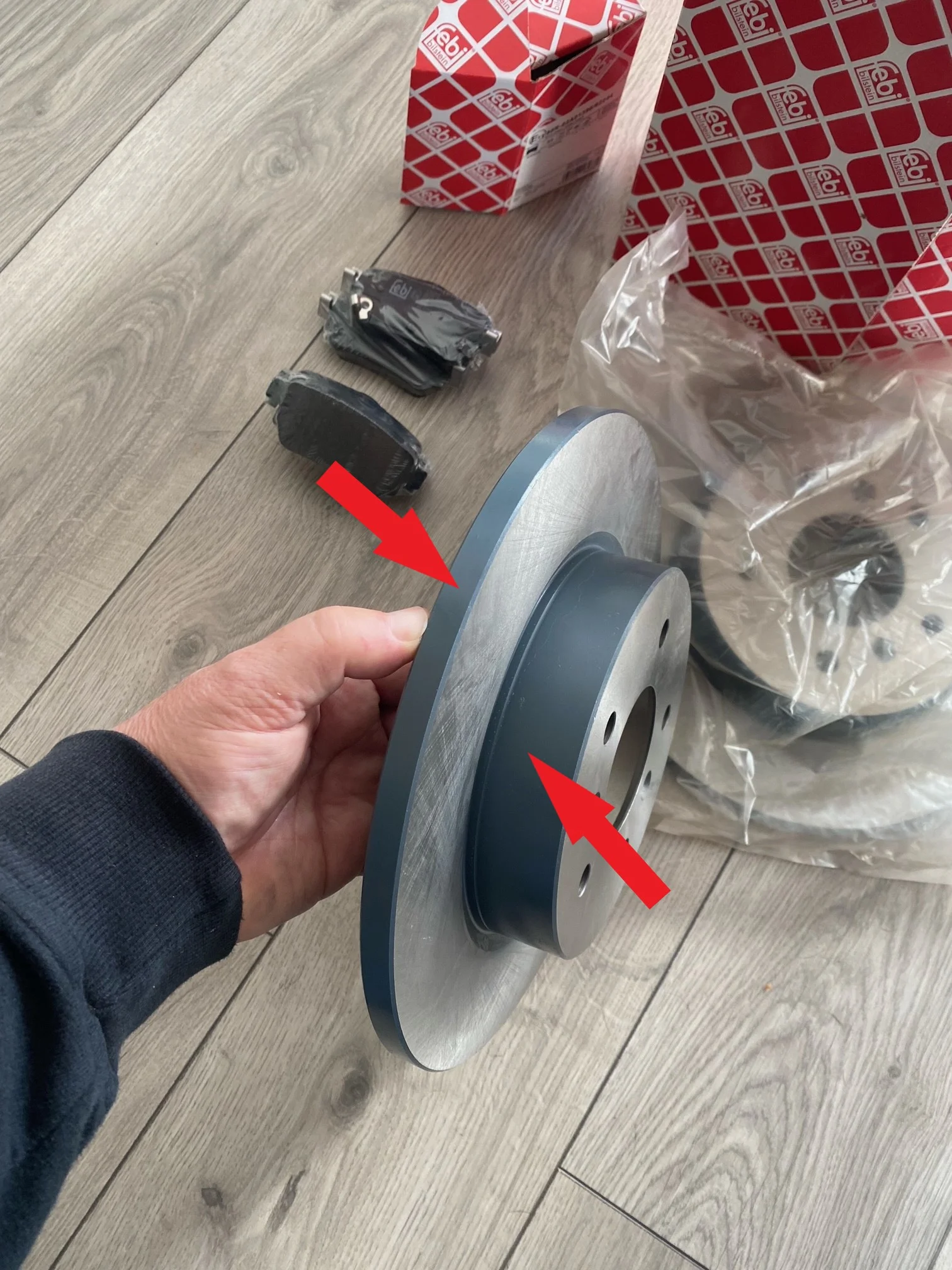

    Renault Kadjar Febi Bilstein Disc showing its protective coating:

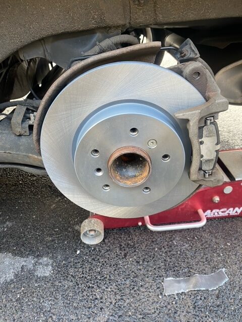

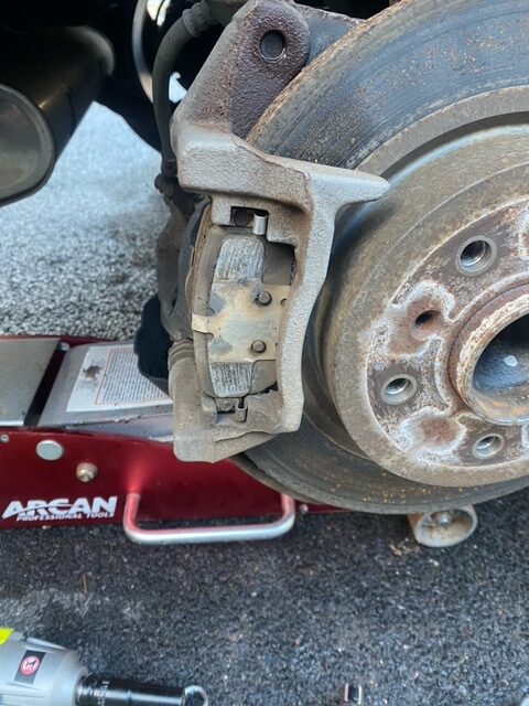

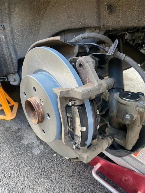

    So managed to find time to fit new Febi Rear brake discs and pads for our Renault Kadjar.
    Took around 2 hours for both sides and went relatively well, only real issue I had was that the Brake Caliper cylinder/piston needed winding in to make room for the new pads and the piston rewind tool I had only fitted on two of the three lugs, minor issue really
    Existing Rear Brake Disc very worn and lots of contamination:
    New Rear Brake Disc with new Brake Pads (face view):
    New Rear Brake Disc with new Brake Pads (side view):
