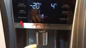

    To activate this Forced Defrost Mode, go to the front panel and …
    Press and hold the Freezer and Lighting buttons simultaneously for approximately 8 seconds, or until the display goes black.
    then using the Lighting button tab through the options until you see Fd (Full Defrost) and then leave this to run for around 30 minutes.
    During the Forced Defrost Mode, the Fridge Freezer makes a beeping noise

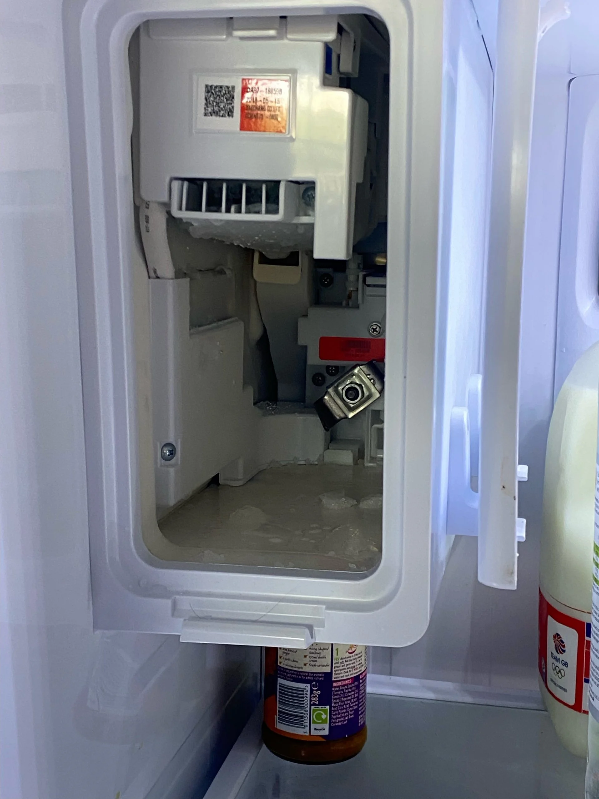

    Ice box before Defrost showing Ice Build Up
    #19024
    So I had to run the Forced Defrost Mode twice and manually remove the last of the ice by hand.
    Picture shows Ice compartment now Ice free and ready to be left running overnight making new ice.

    As a follow on, what I have noticed is that I have only had the freezer coils being frozen problem this year and that is since I activated the Energy Saver option on the Samsung Fridge Freezer ….
    In May / June the ice dispenser stopped working on two occasions, after the second time I turned off the Energy Saver mode and ever since no more ice dispenser issues.

    So out of frustration I think I have finally fixed our Samsung American Style Fridge Freezer Ice compartment from not dispensing ice.
    As a last resort, I added around June the  ‘Samsung Ice Maker Y-Clip Kit’ and also took the opportunity to seal in the Ice compartment with food grade silicone sealant so that no moisture can gain access to the ice compartment.
    Lots of Videos online showing how to fit the Samsung Ice Maker Y-Clip Kit and Seal in Ice box etc.
    Ever since then the Ice dispenser has worked flawlessly.
