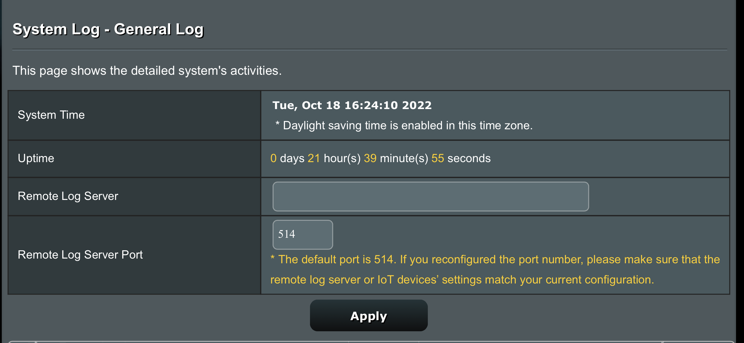

    #21284
    Steven RobertsSteven Roberts
    • Replies 39
    Hi I wondered if it is just me but I have noticed the router is now 1 hour behind since the update. it is sating that ‘Daylight saving time is enabled in this time zone.’ and it is set as GMT London so with BST it should be correct.
    It was right with the previous firmware but am running 3.0.0.4.388_21099

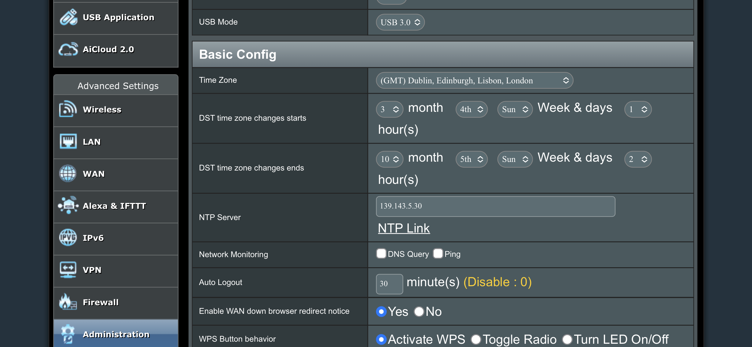

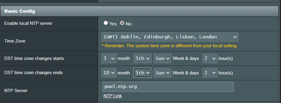

    Hi I wondered if it is just me but I have noticed the router is now 1 hour behind since the update. it is sating that ‘Daylight saving time is enabled in this time zone.’ and it is set as GMT London so with BST it should be correct. It was right with the previous firmware but am running 3.0.0.4.388_21099 Thanks
    I forgot it is that time of year again and had not set mine correctly either, what does your DST Time Zone Changes Ends say for GMT London etc ?
    Should be 5th for both Starts and Ends I believe.
    #21301
    • Replies 997
    In Europe we use last weekend in the month, so yes, 5th is correct and will use 4th if there is no 5th.
    I asked Asus years ago to correct this from 5th to last like it is really implemented, but no interest on their side to make this little viewing-change for clarity.
    What still little confusingly, wheter to use 2nd or 3rd hour in October.
    I think to remember from my testings, that 3rd will be the correct setting to change summertime at 3 to 2 wintertime.
    #21304
    • Replies 8,252
    Yes, the hours are a little confusing, reading one of your old posts ;-) – this is just a set point (marker) when the time format actually changes either 2AM or 3AM in the morning and that is my understanding also

    Your DST Time Zone Changes Ends settings look good, I wonder what the settings where with firmware 3.0.0.4.388.21099
    #21309
    • Replies 39
    I didn’t take a screenshot but did submit feedback when 21099 was still on the router so hopefully asus have a copy.
