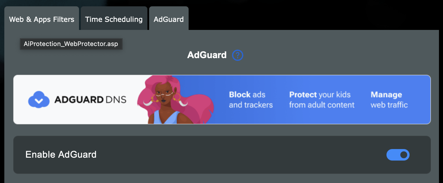

    Has anyone tried to use the built in AdGuard Protection, which can be found under Parental Controls?
    I created my Adguard account and then toggled this on within the router Web GUI and logged into my Adguard account.
    Set up the device and pointed it to the default server.
    Everything was working OK (I could see traffic in my Adguard dashboard and the test site showed I was connected) and then after a few hours all traffic got blocked for all devices connected to my router.

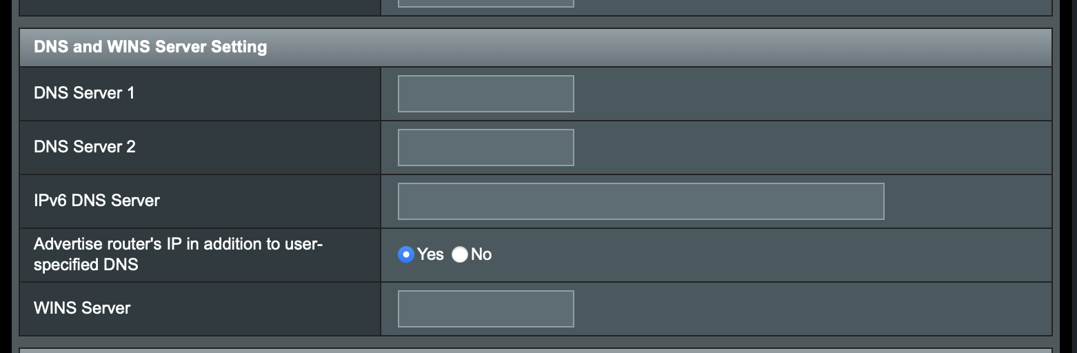

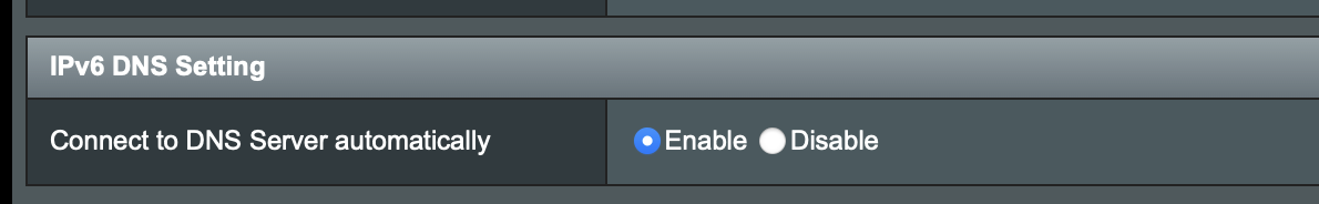

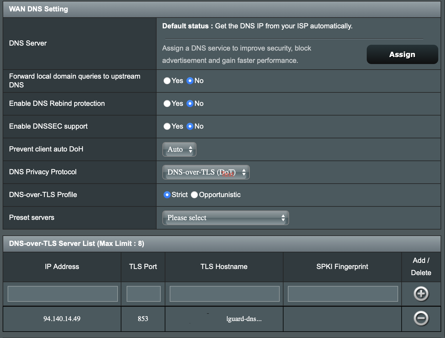

    Attached are some screenshots of the set-up:
    One showing Adguard toggled On
    One showing the WAN DNS settings after turing on Adguard
    One showing the LAN DNS Settings
    One Showing the IPv6 DNS Settings

    Just a quick update on this, I had a good E mail exchange with AdGuard support and they confirmed the primary WAN DNS servers should be set to their public DNS servers, rather than the default ISP DNS,  and they then advised how to set everything up manually (rather than via the toggle switch) for DNS over TLS.
    They also got me to set up my DDNS details within the device (router) settings within AdGuard.
    It is likely the problem I was experiencing was caused by a change in my public IP / WAN address.
