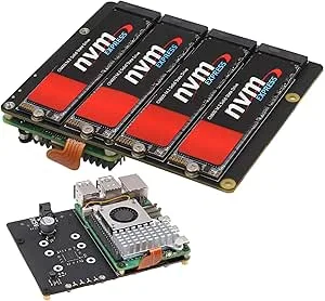

    Not sure what Raspberry pi kit you have already if any,Β  but I did see the option for 4-way NVMe RAID for the Raspberry Pi 5, looks like a mini server.

    This is what I have seen on Amazon around Β£50 for the Raid base and supports NVMe boot.
    Lots of different options for redundancy which is good to see and seen some options for NAS also.
