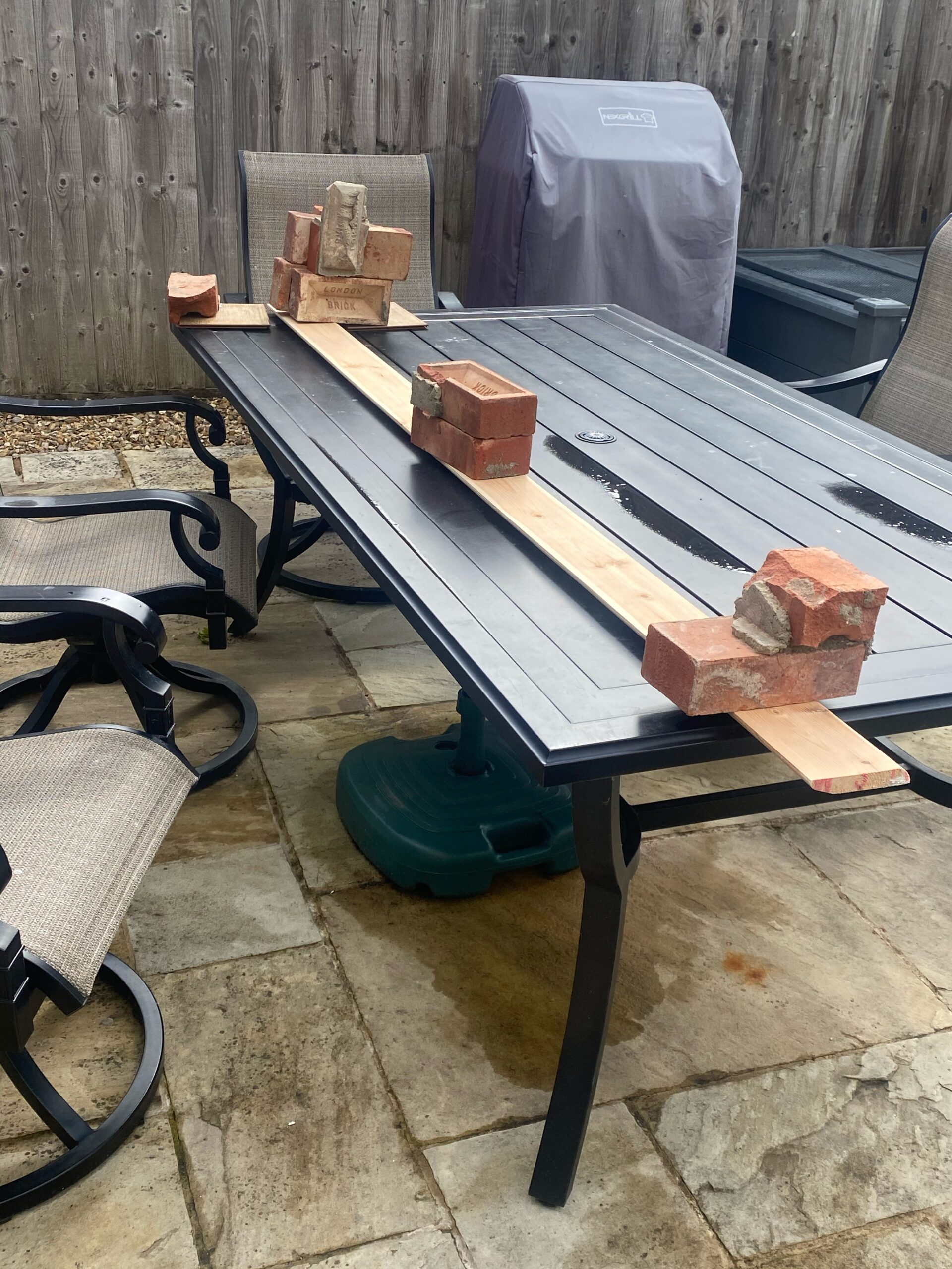

    So while I had my Pine Skirting pack opened with my twisted skirting board, I though i would try to straighten it,
    Placed twisted skirting board on outside table, soaked skirting with water from hose and then placed a few bricks on skirting board over night and allowed to dry the next day. (all in the name of science)
    It did  work to a degree, but way to much effort for a simple skirting job

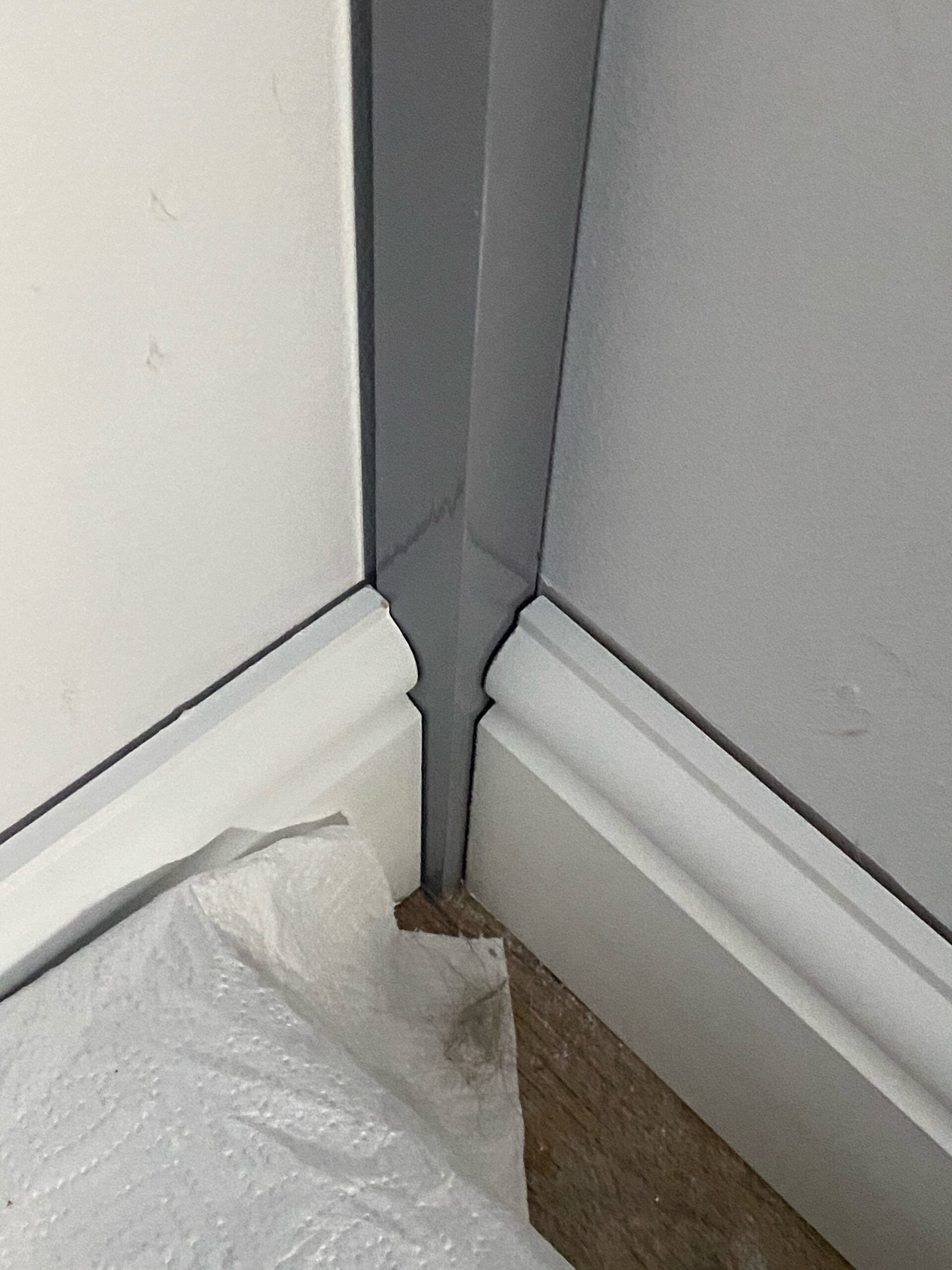

    i tried Pine skirting boards but have found MDF to be much easier to work with an cut around radiator pipes etc. and takes gloss or satin paint very nicely.
    After trying a little experiment, in the form of painting two lengths of MDF skirting with a Satin paint and then attaching to wall with a glue, the painted skirting board takes ages (days) for the paint to dry and if the hardwood floor or wall is uneven, then nails / screws are requires, so I ended up attaching the remaining MDF skirting boards to wall and then applying finishing paint as this made the job much quicker and family friendly.
    Pic below of pre-primed MDF Skirting boards
