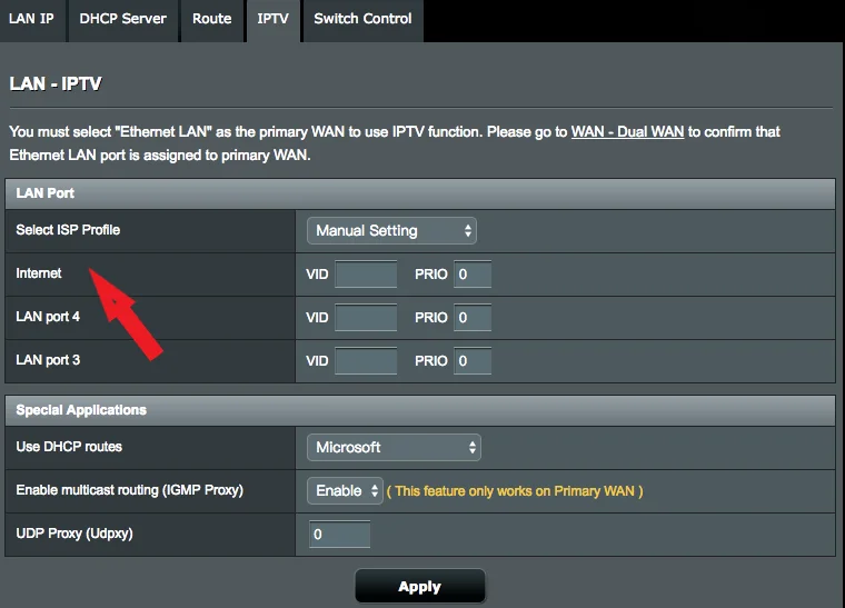

    Welcome, Yes you are correct, the ASUS DSL-AC88U does not support VLAN ID when in Bridge mode.
    But as you are using the ASUS GT BE98 try setting VLAN ID as per below details from a LAN/WAN connection setting via IPTV, never tried this myself so will be an interesting test (Try Internet option)
    Hopefully your ASUS GT BE98 has the IPTV tab, the ASUS GT BE98 is a new release router so firmware maybe not be fully mature yet ?
    https://www.asus.com/us/support/faq/1034366/

    Thank you for the reference. Yes I have those exact settings on my router’s admin page. In Dual Wan I can select the Primary WAN as 10G WAN or 2.5G WAN / LAN1. I think I should select the port where I’m connecting the ethernet cable coming from the modem. In may case it’s 10G WAN.
    I just don’t understand why the ISPs require the VAN ID if it is related with IP TV. I’m not using it and I don’t have a subscription for IP TV either. But it looks like it’s still needed to enter I guess.
    I’ll try to do whatever you say. But my wife is watching something from Apple TV :) I can’t stop the internet. I’ll try a little later. But if it doesn’t work, do you think it’s most probably due to lack of the DSL AC88U’s VAN Id support in bridge mode?

    I do,  most ISP’s require a dedicated VLAN ID just for Internet access and then other VLAN ID’s for streaming etc.
    Use the 10G WAN and give it a try when you can and let us know as using the IPTV work around for VLAN ID should work

    Yes I found the latest firmware and downloaded manually. The check button was showing me I had the latest firmware but I found this firmware in this forum and downloaded it.
    Yes IPTV settings is in the LAN settings. I accessed there and made the following changes as shown in the picture:
    I’m also attaching the settings in Wan. but as you see in the picture 6.png, the internet connection is shown as disconnected.
