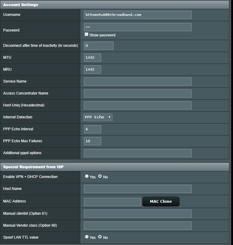

    #3381
    Ian72
    • Replies 46
    I just thought I’d update the thread in case anyone else is doing the same thing.
    Everything was going well, speeds going up and my connection is on fast now on up and down.
    All until last night when I lost connection,looking into things this morning the modem was still connected but the router wasn’t.
    After turning the power off it came back up but at really low speeds for a few minutes,back to normal atm,but why would it do this?
    Also what’s odd is if I run speed tests it makes my son lag badly on games or kicks him form the network completely,he was the first to lose connection last night
    I should have said I now have my Draytek set up correctly in bridge mode,could I have anything set up wrong in my router to cause this behaviour?
    Hopefully just a one off,but wanted to check.
    I’ve added a screenshot of the Draytek set up,I’ve changed the Mtu to 1492 which it was on the Bt home hub and changed the dns to 1.1.1.1 same as the router (not sure if I need to do both)
    Thanks in advance for any help,Asus support were useless said factory reset and if that didn’t work I can only email for more help for level 2 support.
    #3386
    Ian72
    • Replies 46
    Also could the modem dns be why?
    I’m confused on the page that I uploaded in my last post I’ve set the dns to 1.1.1.1  but on this page it’s google dns.
    Also on the router lan page it has settings for dns,not sure what I should have set or not!
    Internet speed has gone really slow again
    The strange thing is my son was watching youtube with no buffering at all,yet on all other devices it was at a crawl including speed test.
    With an 80/20 connection it shoudln’t do this,my router/settings or Bt ? Although if the modem says the speeds I posted I’m getting the right speed I guess.
