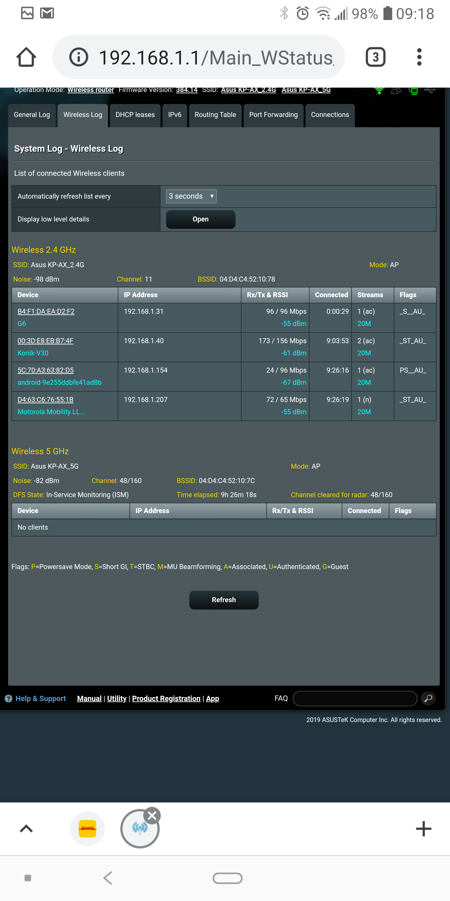

    login to router , click on system log –> wireless log
    post screenshot of that ?  ( hide MAC address and device that are not having issue before posting )
    also i want to ask which site are u using to test speedtest.net ? or fast.com ?

    Screenshot attached, mine is second from top (currently on 2.4 Ghz) , one above is my wife LG G6 for comparison. Not much connected yet as kids just woke up 😝

    why you have connected  AC devices on 2.4Ghz ?  ( name G6 . V30 , android )
    connect them to 5Ghz ? and speed test ?  ( also use static channel number between 36 to 48 or 149+ ) and if there is issue test it on 80MHz bandwidth .. ( 160MHz use DFS soo sometimes connectivity issue comes up with some devices .. where SSID not showing etc etc )
    G6 is 2 Streams  but it seems to be connected at 1 streams  = max link speed will be 433Mbps on 5Ghz
    V30 is connected at 2 streams = so max link speed will 866Mbps on 5Ghz
    android i cant say by name but connected at 1 stream = so max speed link speed will be 433Mbps on 5Ghz
    here in 5Ghz AC Wave 2
    1 stream = 1×1 MIMO = 433Mbps
    2 Streams = 2×2 MIMO = 433Mbps x 2 = 866Mbps
    2×2 AC device @ 80MHz  @ channel 36 = 866Mbps = 216.5 Mbps x 4  20MHz channels comb (36 ,40 , 44 , 48 )
    2×2 AC device @ 160MHz @ channel 36 = 1,732 Mbps =2165.5 Mbps x 8 20MHz channels comb ( 36, 40, 44 , 48 and DFS channel 52, 56, 60, 64 )
    please correct me if i’m wrong
