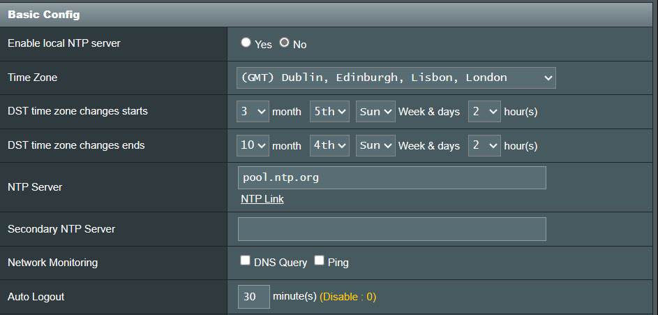

    Is this correct?

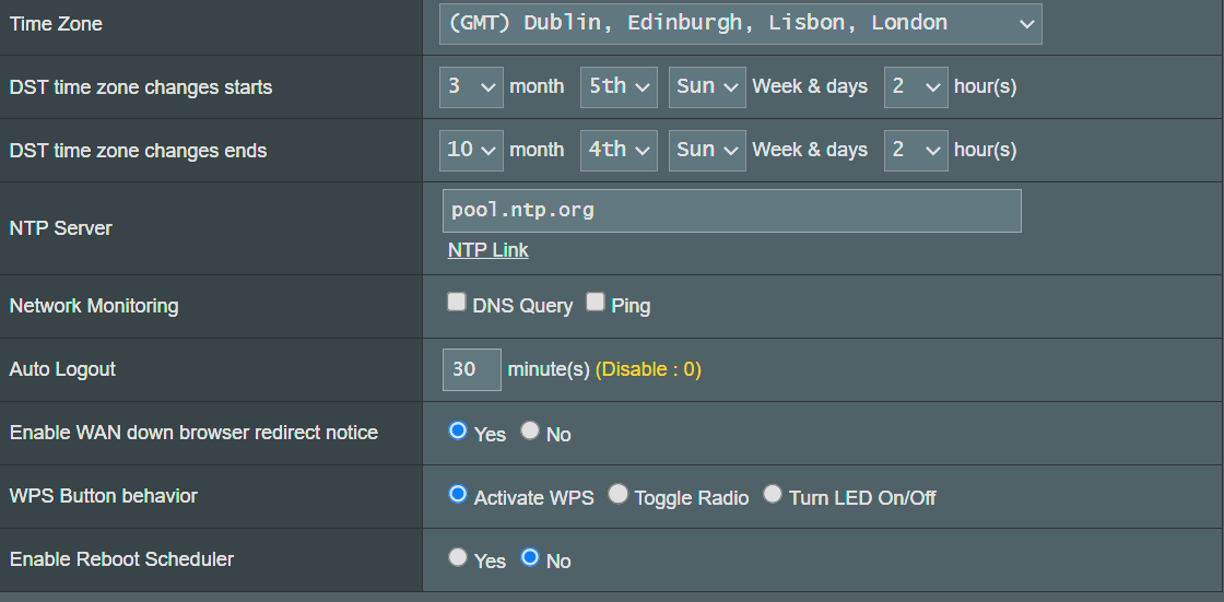

    This year, for March 2024, DST change is March 31st which is the 5th Sunday, usually its the 4th, but this year the last Sunday of the month is also the last day of the month
    This is my ASUS Daylight Saving Time Settings for this 2024

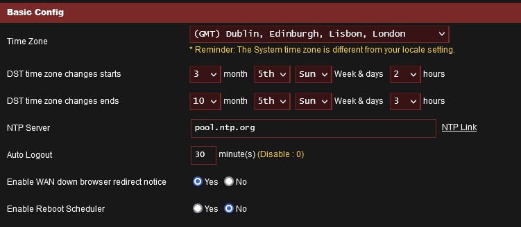

    #31347
    Start time is correct now, but still end time shoul be changed in the sam way with 5th and 3 hours (which means at 3am summertime it will change to 2am standard time).
    And you can leave it forewer, 5th is fine and interpreted as last sunday in a month, which is always correct.
    If you set 2 hours at the end time it will change at 2am summertime to 1am standard time, which is not the defiition of EU time change.

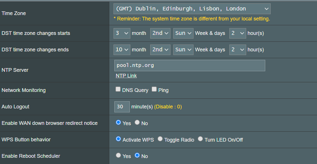

    Sorry, but doesnt work for me to change values.
    After 10 attempts I got it.
    Here are the correct settings for EU and GB, beside individual city/timezone.
