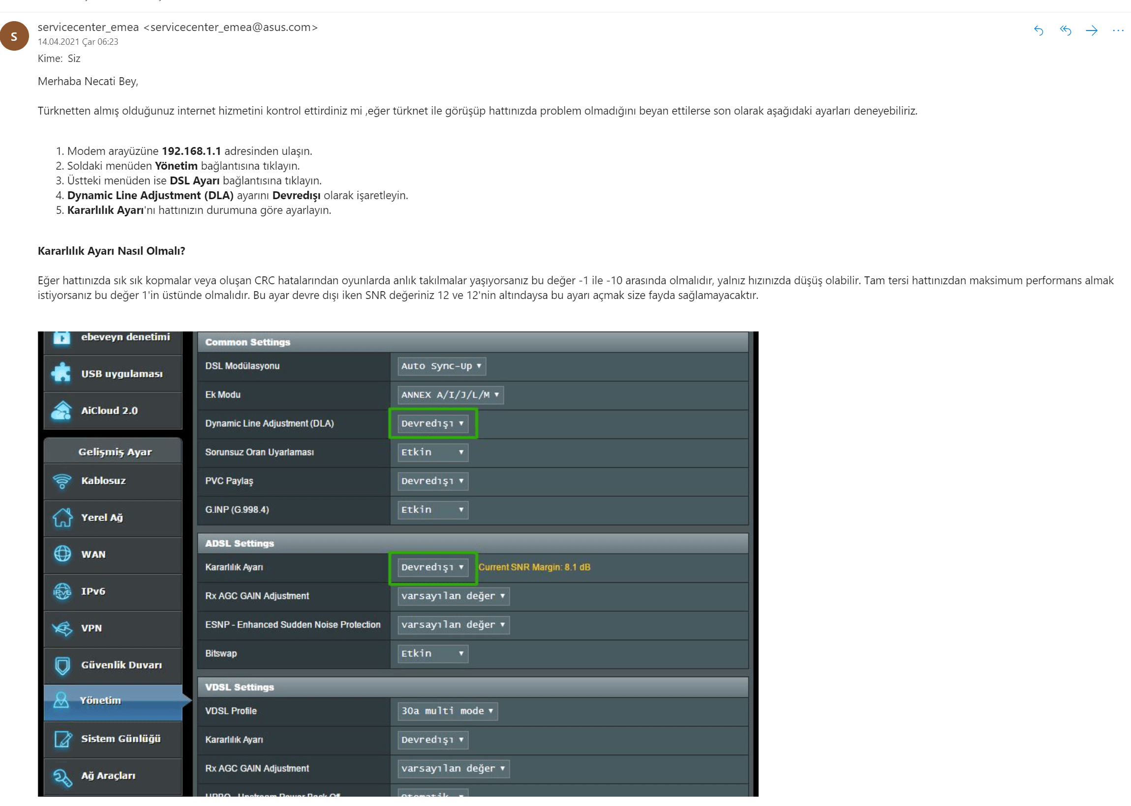

    Thanks for your reply, I contacted asus a lot, I am adding the answer they sent me, there is no solution, they say send me to the service, but they will upload software and send it to the service until then, I will be without internet until then, I know you are an expert in technical issues, there is no physical problem, but this modem ac51 is problematic, exchange and return is not accepted. they didn’t
    can you change iss?
