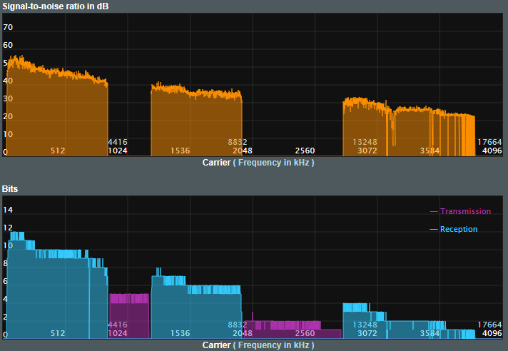

    #13987
    Line grafics look unspectacularly, quite like it should.
    And problems may be caused by poor backbone of the provider too as long as CRC are not extreme.
