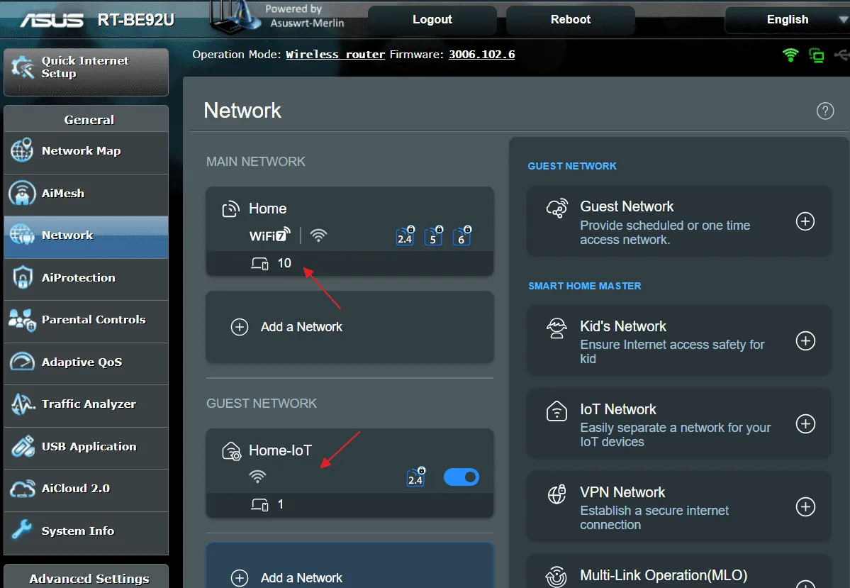

    Starting from firmware version 3.0.0.6.102_35404, the name will change from [Guest Network Pro] to [Network].
    The RT-BE92U does have ‘Network’ as does the RT-BE86U,  ‘sip pass-through’ is standard on all ASUS routers as I remember my older RT-AC86U also had this option.
    I cannot see and VLAN options on my RT-BE92U, but I believe you are correct that the RT-BE86U supports VLAN ID’s on the LAN which maybe better suited for your requirments.

    I quiet like the new interface showing x devices and 2.4, 5ghz etc.  Is that only on Merlin or is that on stock firmware too? the BE86U doesn’t have 6ghz band, only dual band 2.4 and 5gz but should be ok, apart from 2 mobiles and maybe 1 iPad pro, I think that is all that’s WIFI 7 compatible I have and maybe 6ghz compatible.  All my IoT devices i.e. smart thermostat, smart plugs are all 2.4 only and need b/g/n I believe to work and they are fairly crucial to ensure work as I access those remotely when not at home to check things and turn on/off heating etc if outside of standard schedule so need to ensure they all continue to work hence will set up guest with same SSID and pswd to avoid having to re-do all the devices as might take a while to do. The BE96U has tri band I believe but that is way way too price, couldn’t justify the cost just for a home router.

    The new interface is rather interesting and is standard on stock firmware also. (I’m still getting used to it myself).

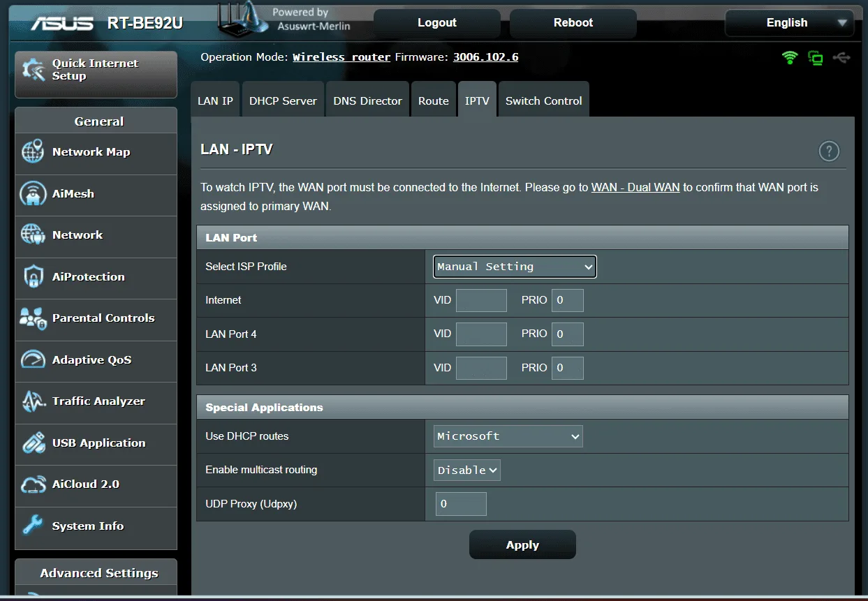

    Can you check on RT-BE92U from the web GUI, go to Advanced Settings > LAN > IPTV tab. > Select ISP Profile > Manual Settings VID is VLAN option

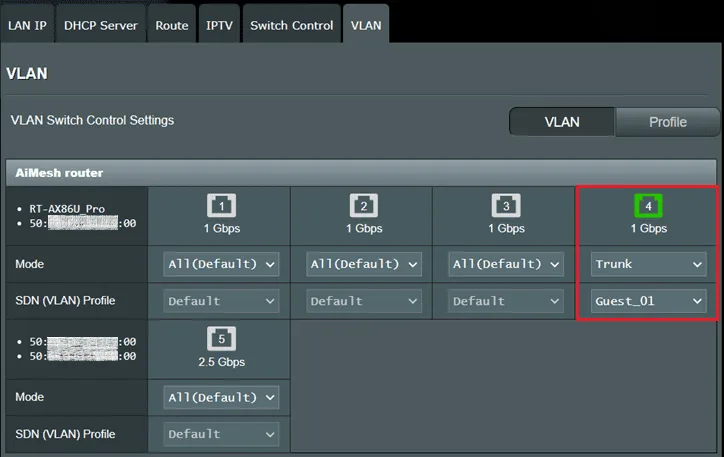

    btw. screen from attachment below is not from RT-BE92U

    My RT-BE92U IPTV setting page has VLAN to WAN option for IPTV services which serves ISP‑specific VLAN tagging for IPTV services.
    Note; this is not the same as the VLAN options on say the ASUS RT-BE86U.
    ASUS VLAN Tab (more comprehensive – not available on RT-BE92U)
