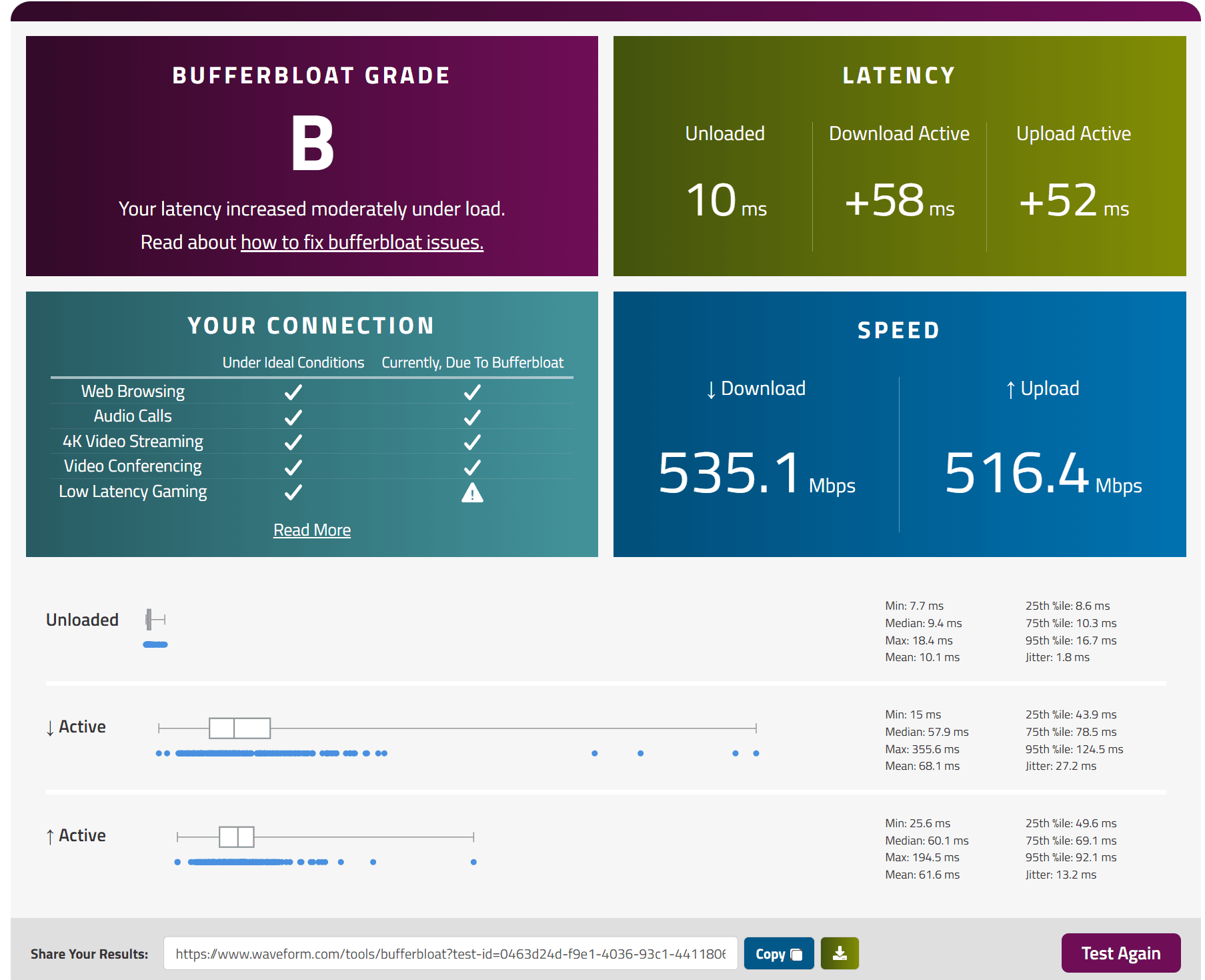

    It seems like the web GUI has become snappier for me now, much better than when I first set it up in the afternoon.
    Also did a ‘bufferbloat’ test and got B.  With the XT8’s it was mostly C.  This is with me connected wirelessly to the furthest away node.
