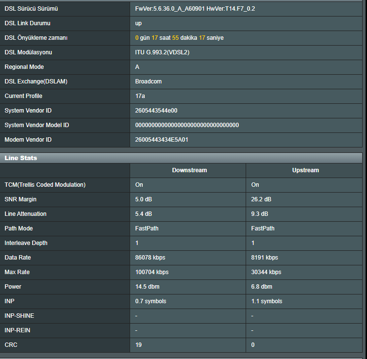

    #15917
    problem can be in your xdsl line.. can you share line status with us ?
    Half-Life 1 Server IP: hl.oyunsen.com:27015
    We will re-write code of world…
    #15919
    Firmware Version: 9.1.2.3_945-g470b0ea
    no problem :)
    #15921
    • Replies 8,682
    Will be interesting to see what CRC’s would be after two days ;)
    #15922
    DSL Önyükleme zamanı
    0 gün 21 saat 24 dakika 22 saniye
    CRC
    32
    nowly, crc is this :) i will write two days later.
