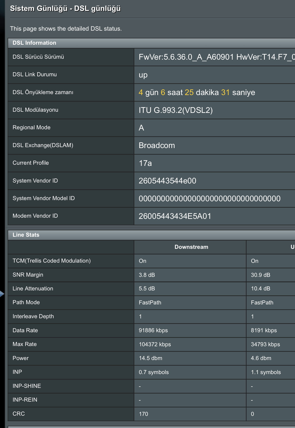

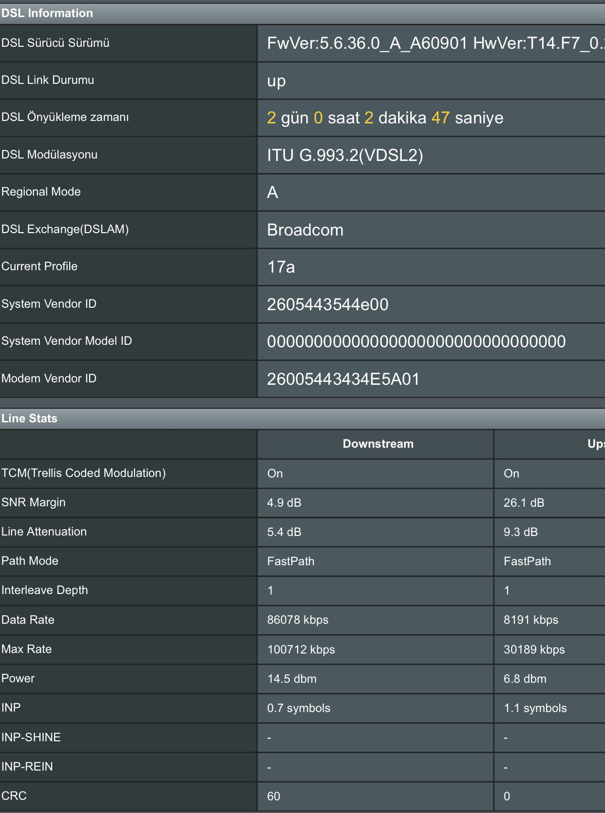

    24 hours passed and crc is in picture. Test success.

    Yes, much better CRC rate so far

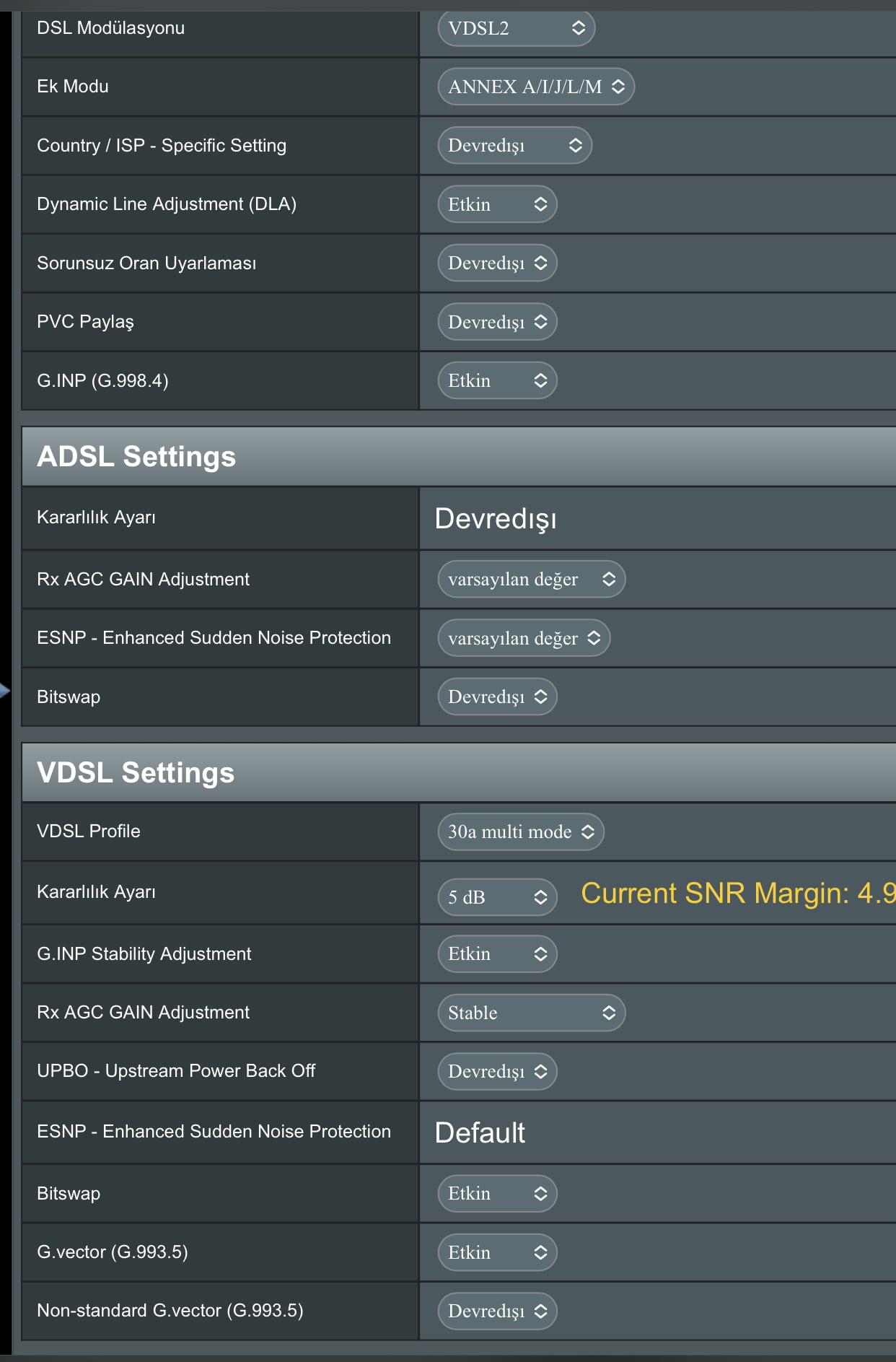

    i use some config ✅
    tr: evet ayar kullanıyorum, default ayarları kullanmıyorum
    #15939
    my config set is in attached picture.

    dsl uptime 4 days 6 hours and crc 170 :)
    best regards
    #16093
    [quote quote=16090]dsl uptime 4 days 6 hours and crc 170 :)[/quote]
    170 CRC, much better with newer firmware
    #16094
    yes bro, new firmware is stable and have less crc error nowly. Single problem stayed-> Late connection problem. I hope Asus will solve it. Thanks

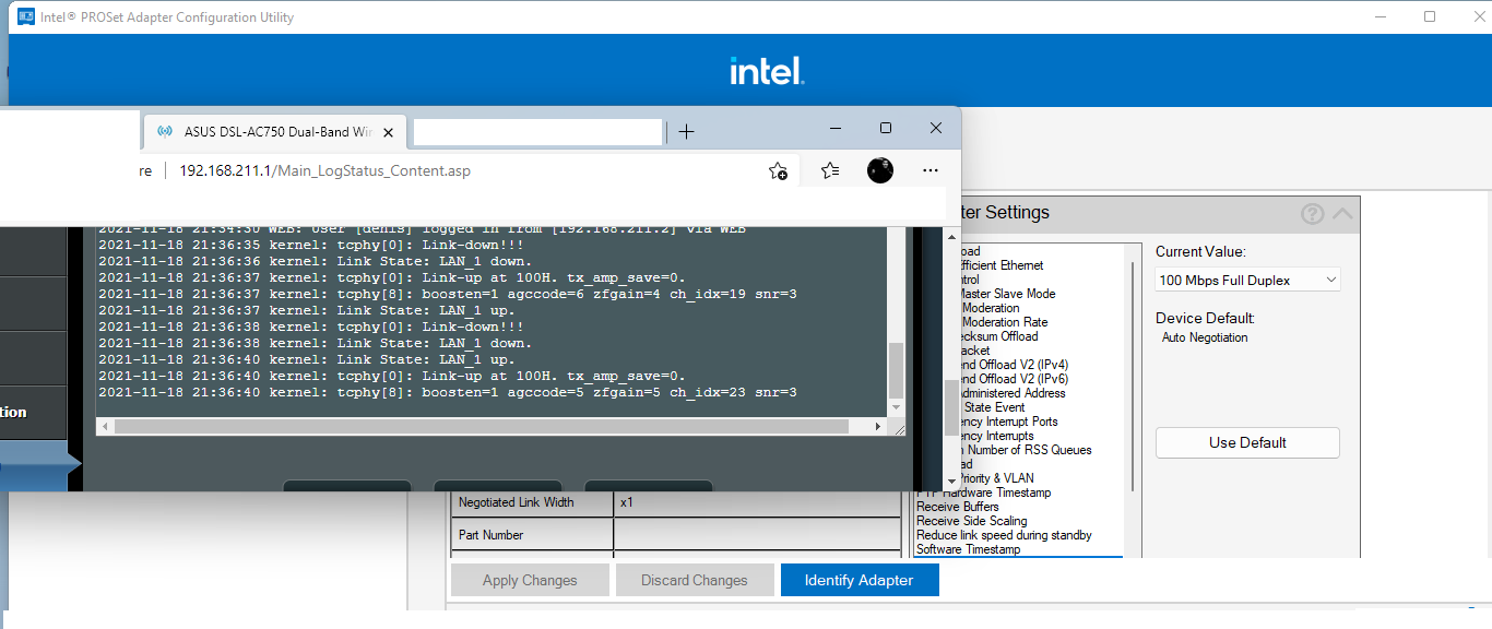

    With latest firmware you gave i got better CRC and i’m positive about it, but i have this problems.
    When windows is configured to 100Mbps Full the line get 100H(Half ?). The log seem to say this for configured 100F or 100H from the computer. If i don’t configure it from windows or intel tool and i leave it to auto conf log say 100F.
