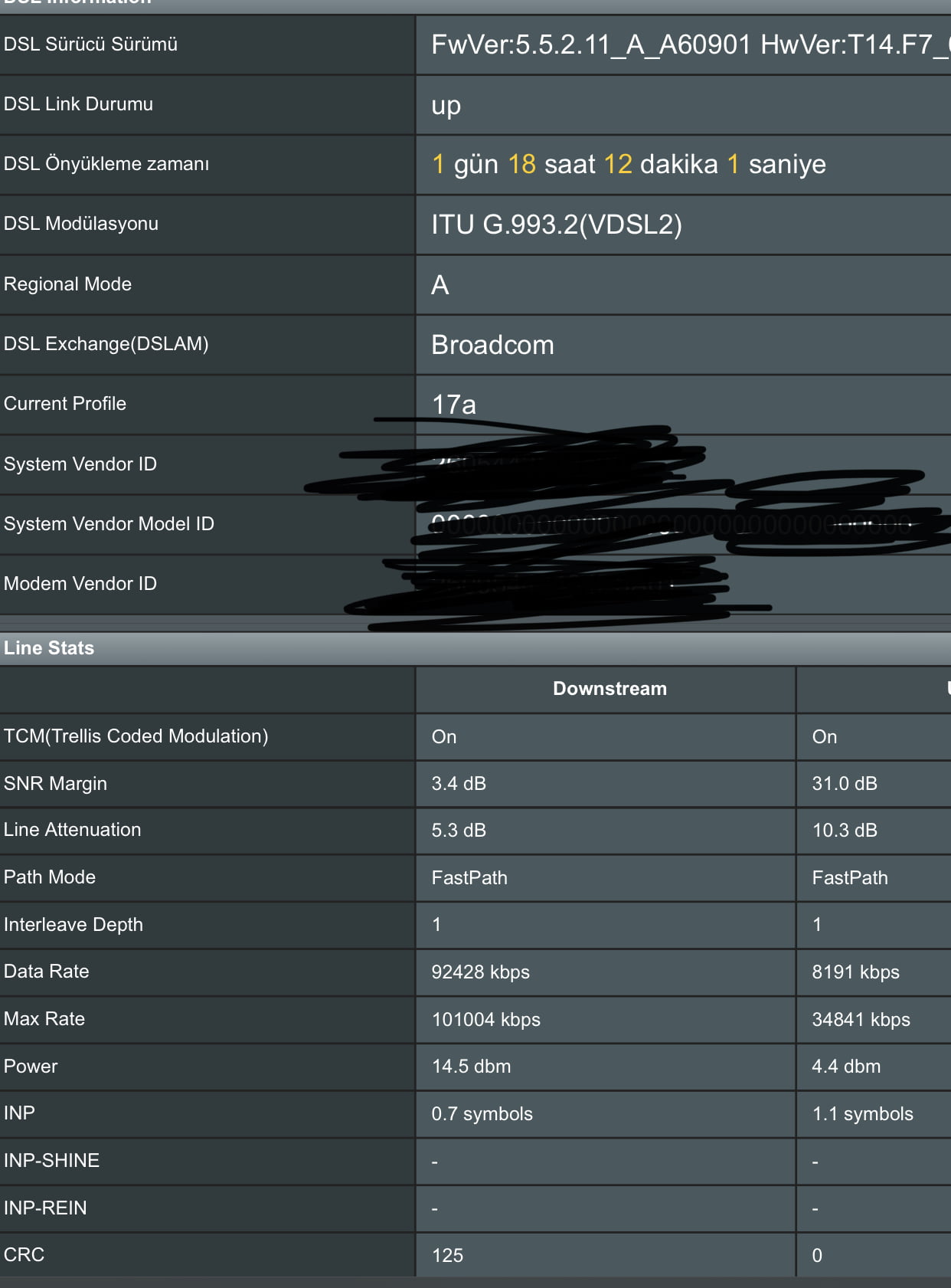

    How much crc have you received so far with 805 Onur? I have 223 CRC in 1 day 13 hours with 790.
    #16397
    kaan i took 93 crc errors for 25 hours with v805 firmware.
    #16400
    AvatarKaan
    • Replies 31
    Do you have specific dsl and wireless settings? If you have can you show your dsl settings and wireless settings?

    i added my dsl config and crc error page. i use vdsl2 at Turknet.
    #16438
    AvatarKaan
    • Replies 31
    I am also using vdls 2 Turknet. Thank you for sharing your dsl settings with me.

    stable version 805 is very good. you can look my added picture.
    #16512
