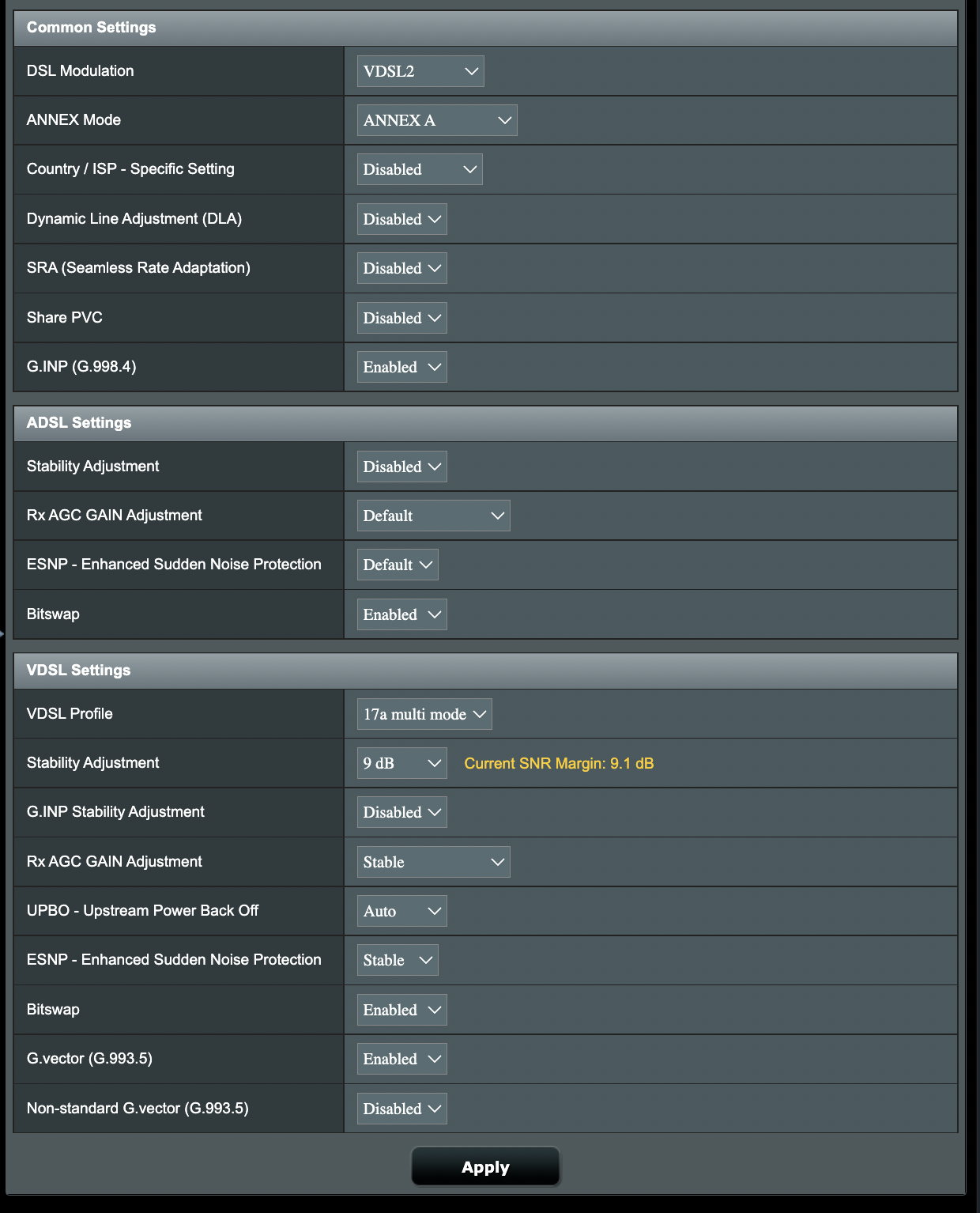

    I am using 979  My snr margin pointed 9db and I have only 9073 CRC for 3 days. It is very good.
    My settings on attachments

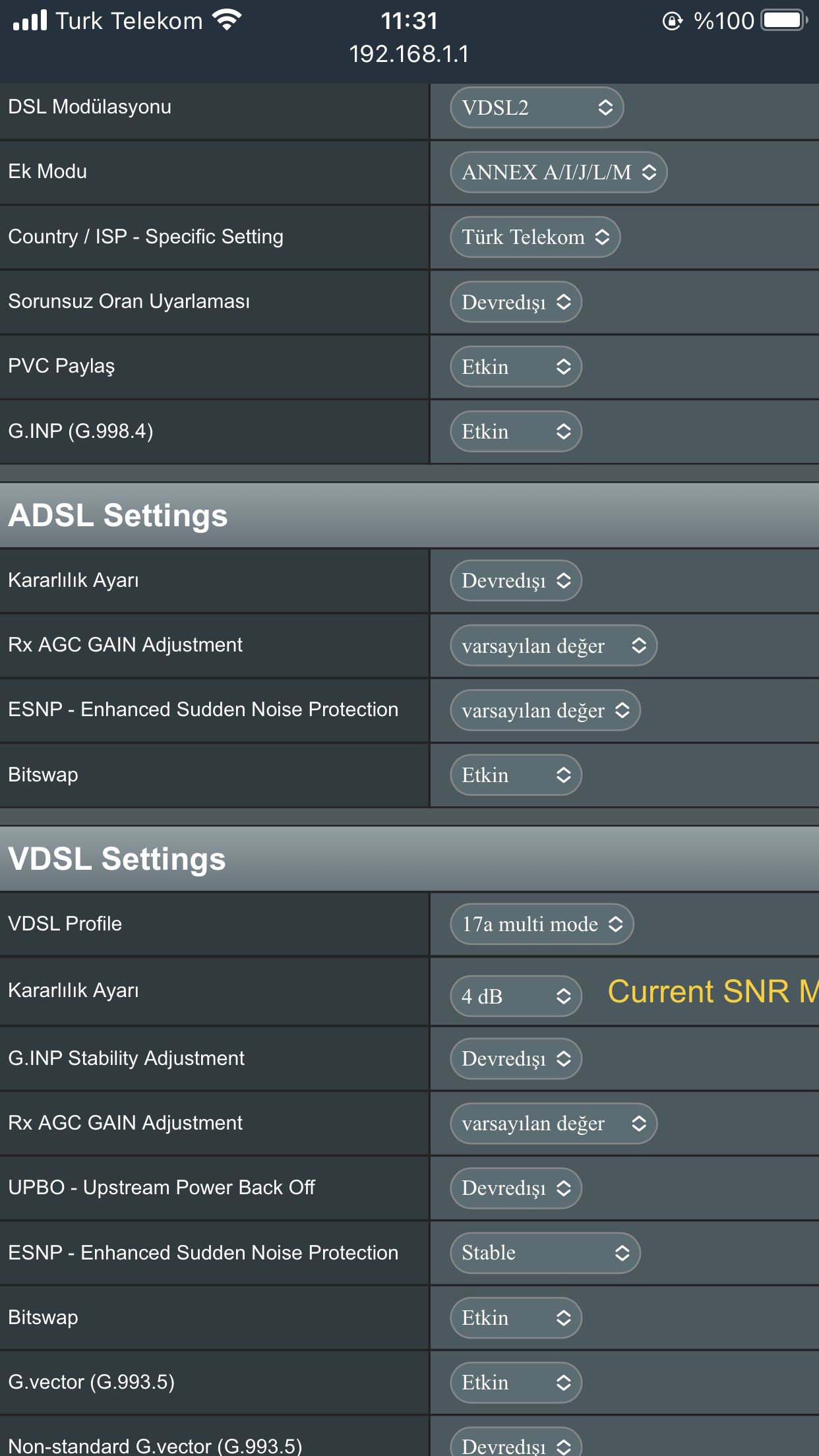

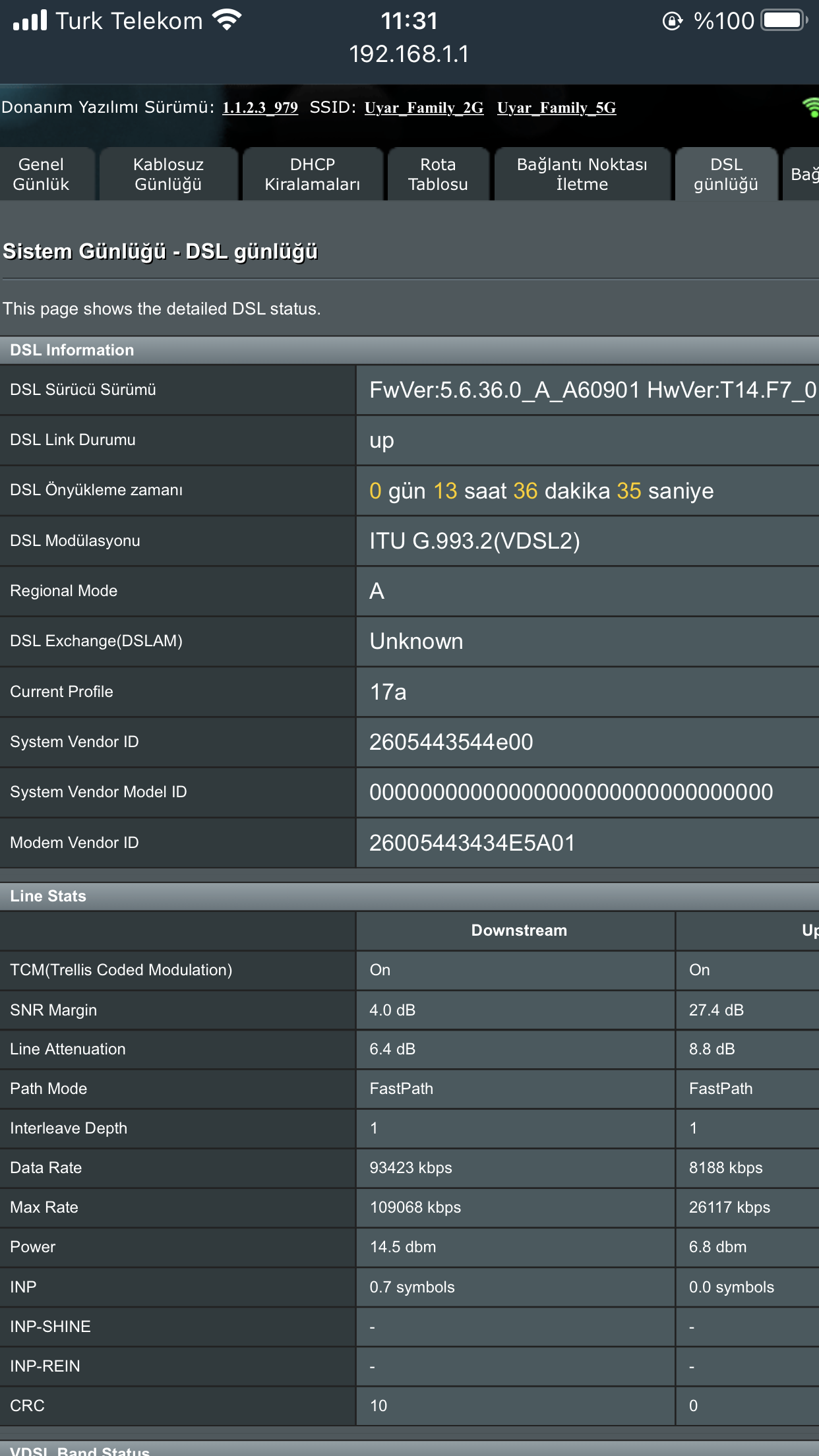

    i solved my crc problem at version 979 (device ac51). crc errrors are 10 in 13 hours. I attached my dsl config and dsl status.
    #20993
    Stats look much better  – what did you do to lower CRC’s with 979  ?
    #20994
    [quote quote=20993]Stats look much better – what did you do to lower CRC’s with 979 ?[/quote]
    I made the settings in the picture I added in the subject attachment and the problem was solved. I was not physically involved.
