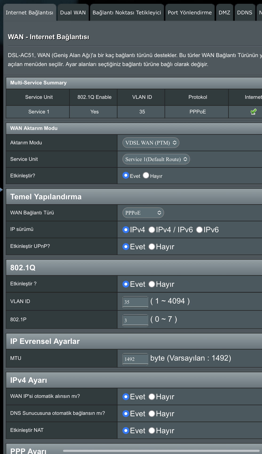

    wan config
    #17120
    AvatarKaan
    • Replies 31
    Thank you very much I really need these settings. Did you change any wan setting also? Can you share all the settings that you changed because your net is so stable I think. I just got wan settings thank you.
    #17122
    AvatarKaan
    • Replies 31
    You changed from wan setting 802.1P   0 to 3 ,  and from professional settings you changed RTIM and İşret aralığı also. Am I right? I saw other different settings, but I’m asking this because I never saw someone who changed these settings also.

    yes, i changed wan settings 0 to 3 only. And some wi-fi rtim changed.

    10 hours 102 CRC. I think it’s normal. Maybe I can make a setting for restarting modem every night automatically. What do you think about it?
    #17134
    [quote quote=17133]10 hours 102 CRC. I think it’s normal. Maybe I can make a setting for restarting modem every night automatically. What do you think about it?[/quote]
    Restarting modem every night may effect you line synch rate
    I had previously set the modem to restart every 2 days, but this was no longer necessary after the last settings I made. 300-500 crc error in 24 hours is not much of a problem, of course, 0 crc errors, but this is impossible in Turkey :)
