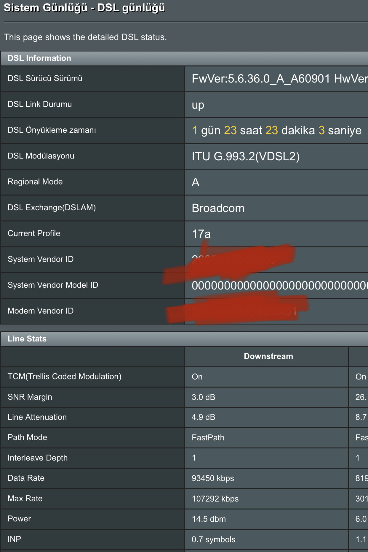

    When I set the snr to 15db, I do not get Crc errors in any version. I will write like this; For 960 version, same settings same 3db higher Crc error. Same settings same 3db I get less Crc error in 959 version.
    Perfect, <noscript></noscript>Edit: Do you have many DSL line disconnects with 3dB SNR with .959 ?[/quote]
    no no, i dont have got any disconnecting problems with 3db snr at 959. I added screenshot.
    #17430
    • Replies 8,722
    [quote quote=17427]no no, i dont have got any disconnecting problems with 3db snr at 959. I added screenshot.[/quote]
    I will let ASUS know .959 is good
    #17436
    [quote quote=17430]
    I will let ASUS know .959 is good <noscript><noscript></noscript>[/quote]
    thanks. asus can do this official version
