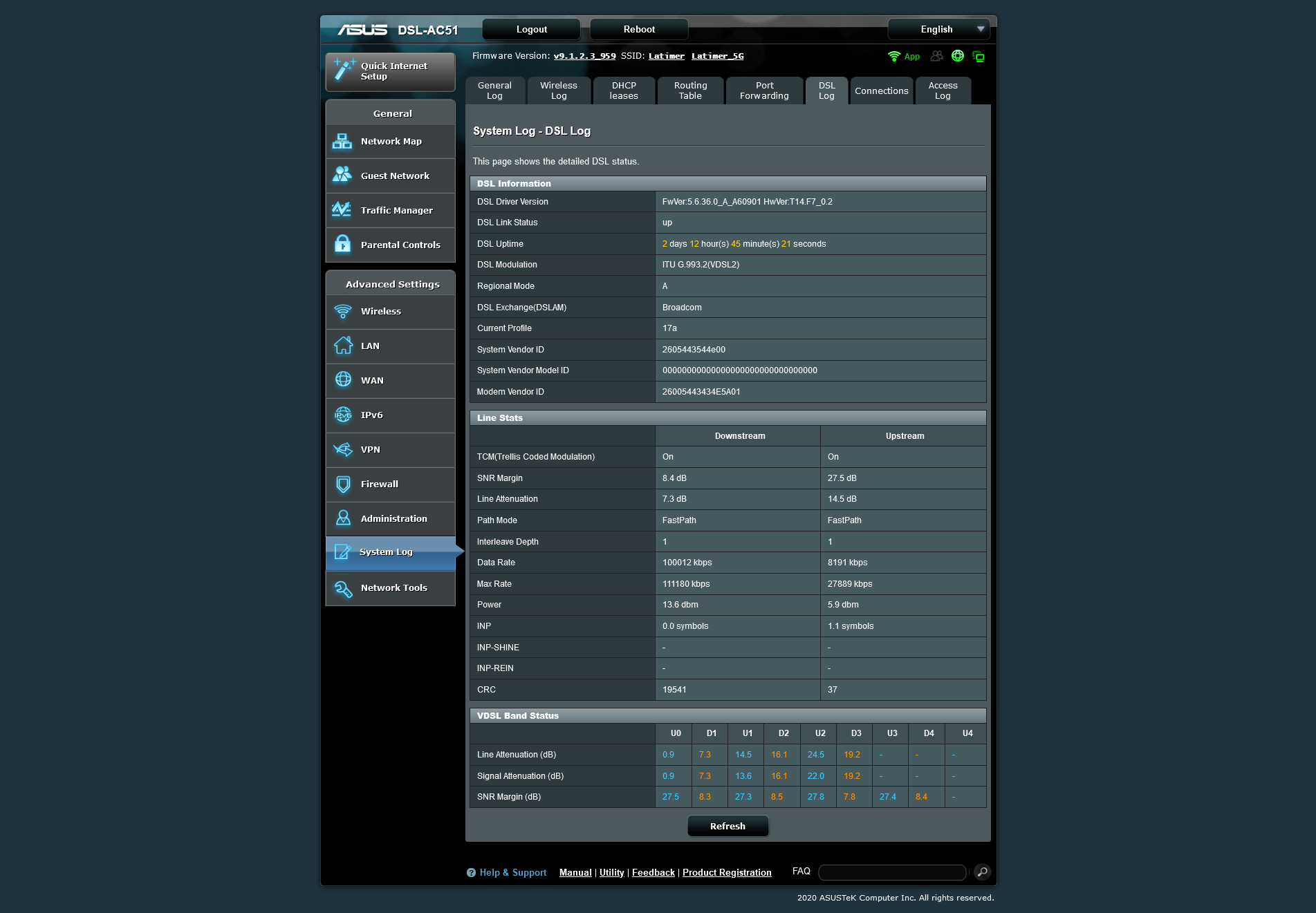

    @UK Sentinel Even though I mainly play games or watch streaming services, CRC does not disturb my games. I don’t have any disconnection problems or sudden high pings etc. Still, I’m curious about the reason for this CRC, and if I can, I prefer to remove it.
    @Invisible
    I’m attaching my DSL log and DSL settings.

    #17614
    Avatarcrc
    • Replies 14
    [quote quote=17547]you must close all settings (not bitswap) from DSL Config area.. or you must do hard reset to modem.[/quote]
    I did an hard reset, but didn’t change any settings. CRC got worse (attached). Could you tell me what do you mean by getting everything closed except bitswap? Should I disable every dsl settings to make it work?
    @UK Sentinel If I can find a dsl filter at home (I know I have one in somewhere in home) I’ll try it. But I don’t have any motors or lamps that can cause interference near the modem.

    After doing the settings, this is the current status.
    It is around 0.5 CRC/min but sometimes there are spikes, so the CRC errors go sky high for a minute and then 0.5CRC/min again.
    It doesn’t need a reset to keep the speed though.
