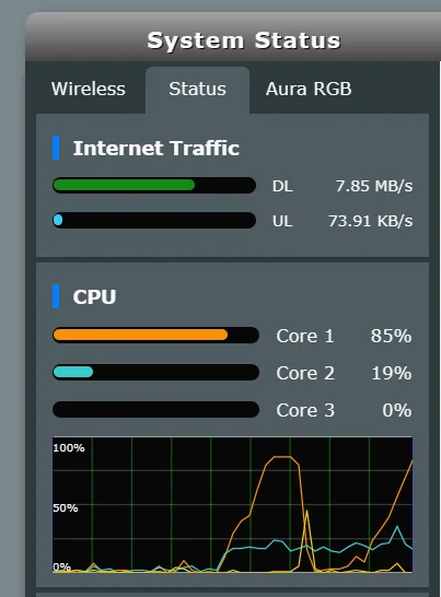

    CAKE is very processor intensive, more so than  fq_codel.
    I seem to remember a conversation with ASUS I had that the Broadcom chipsets support a type of Symmetric multiprocessing., so some offloading will happen
    My CPU Core 1 hit 85% whilst downloading a large file from the internet.
