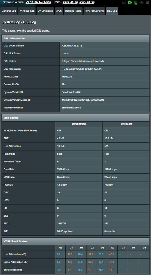

    I am back on beta585.  DLM has now given me full sync speed with a bit of room to Max rate.  Surprising as it’s been freezing cold for the past 2-3 days.
    Are these error counts acceptable for VDSL2?
    #1563
    • Replies 8,738
    FEC are a result of Interleaving and usually means all is well, you numbers over a 12 hour period are nothing exceptional, when you say get a million, every 10 minutes, then time to investigate
    If you are still worried, you could  plug your router into the test socket located behind your master socket faceplate, change the microfilter and record the new stats?
    It is the CRC that you need to keep an eye on, just incase there is to much noise on the line, yours stats are fine at moment, but keep an eye on CRC/s and if the rate per day increases etc.

    [quote quote=1563]It is the CRC that you need to keep an eye on, just incase there is to much noise on the line, yours stats are fine at moment, but keep an eye on CRC/s and if the rate per day increases etc.[/quote]
    Thanks, I will keep an eye on the CRC and ES errors.  What level is considered normal?
    #1565
    • Replies 8,738
    That is a tricky question, the old DSl-AC68U with its Mediatek CHipset was prone to creat very high CRS/FEC compared to say a Broadcom DSL Chipset and LAntic based DSL Modem routers are exact opposite (Fritz!Box, as my Fritz!Box 3490 prodiced only 1 or 2 every other day or so.
    It is also dependant on you line length, DSL line condition, and whether the line, for example is mounted on a pole, and being bashed by tree branches etc. or underground like mine is.
    If you start receiving a few hundred every few hours, where as previously, you received very few, then this is an indication, something is not well with your line
