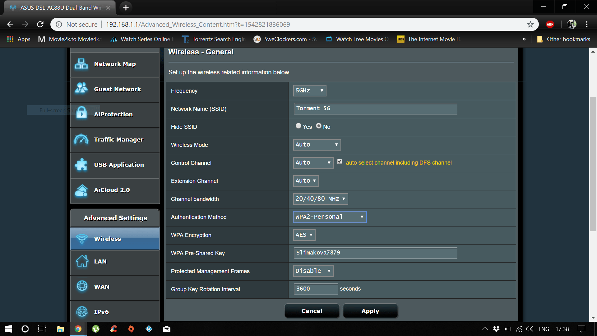

    Hi Guys Still got some issues with wifi but its only on the 5g air fairness is off. And its not like im losing connection to wifi its internet im losing and its so random . And having some problems setting up my vpn trying to use nordvpn on the openvpn folowd all the instruction but my speed end up like 3mbps and using the app on laptop or mobile i got 50mbps Thnk you for all your ides
    Did you try changing wifi Encryption (Authentication) to WEP, just for testing on 5GHz?

    i cant for the life of me find the setting
    here is a snippet
    #1578
    • Replies 8,705
    I just turned mine On and Alas the DSL-AC88U does not have WEP, try changing Group Key Rotation value to 0
    Also try changing Channel Bandwidth to 20MHz and under Control Channel, disable the use of DFS Channels, trial and error I am afraid.
