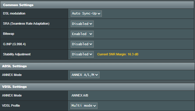

    Sure, here is my settings. I disabled g.inp because if I enable that syncing up takes too much time on both of my modems so I disabled it.
    #21721
    • Replies 8,718
    Thanks, there are a couple of tweaks we could apply but if OK with yourself, I will chat with ASUS DSL Team and see if they can advise on what the best options for DSL Settings for Turkey are etc ?
    Q. is you ISP – Turk Telekomunikasyon ?

    [quote quote=21721]Thanks, there are a couple of tweaks we could apply but if OK with yourself, I will chat with ASUS DSL Team and see if they can advise on what the best options for DSL Settings for Turkey are etc ? Q. is you ISP – Turk Telekomunikasyon ?[/quote]
    Your settings are correct except for the stability settings. Is there a time difference between the two devices or were they tested on the same day?

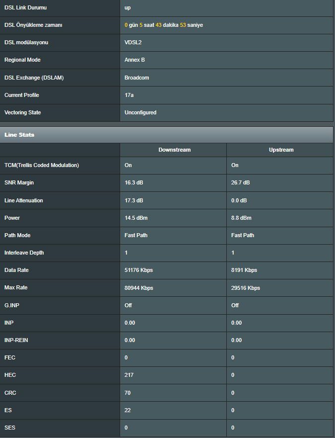

    So I have had a chat with ASUS but need to check one more setting, can you screen dump your DSL-AC52U DSL settings page.
    Are you on a capped service, i.e. do you pay for 30Mbps or 50 Mbps downstream or simular ?

    Hey, sorry for my late answer. My line was very close to the naked power lines so I told them it is a fire hazard and managed to make my isp put a new pole for my dsl line. When doing that they accidentally killed the already old and damaged cable so I’m getting no signal and waiting for them to connect a new cable to my house.
    Here is my dsl settings:
