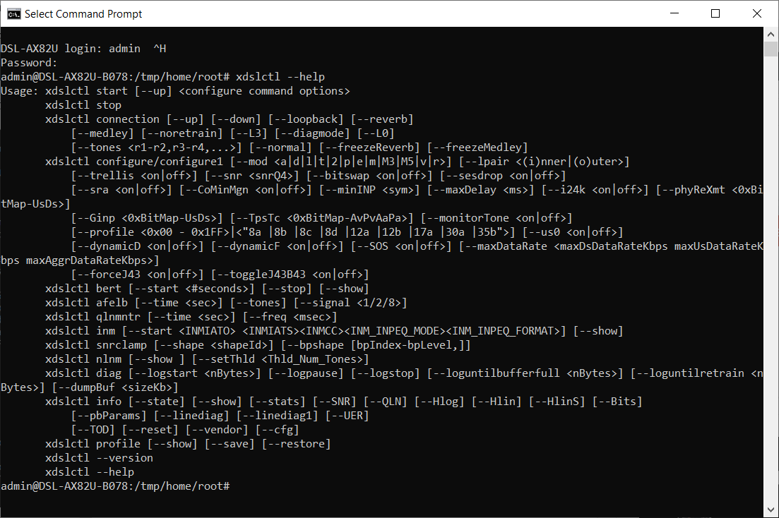

    #12660
    • Replies 8,735
    So I tried the CMD – bcm_xdslctl configure –maxDataRate 102400 57599 524280
    and seems not to like the bcm_xdslctl element.
    Command (xdslcmd –help)

    • Replies 146
    Did you try this code instead
    or
    xdslctl configure1 –maxDataRate 102400 57599 524280
