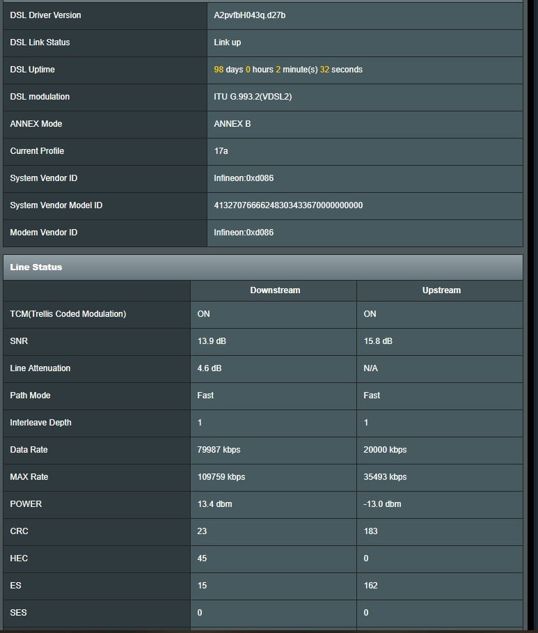

    Infineon to infineon … fast – is this what you were saying you were yet to see UK Sentinel?
    DSL up 91 days, router at 105 now.
    #3709
    • Replies 8,458
    @pavif, well first time for everything ;-) thanks for stats, very impressive, are your FEC high?
    #3710
    AvatarMrk26
    • Replies 465
    @pavlf what is your fw version, also I can tell from your screenshot that your cab got newer fw than mine.
    What is yors fec stats and how long took for you to go on fast patch?
    #3711
    Avatarpavlf
    • Replies 70
    I’m on 591. Not sure what FEC is? Hehehe. If you tell me then I can tell you. It seems pretty fast to me. Faster than my IP says it should be :-)
    #3712
    Avatarpavlf
    • Replies 70
    Sorry – also went onto fast immediately. I’m with talktalk in the UK. The cabinet is literally outside my house and the exchange is only a few hundred meters away. May explain things!
    #3713
    Avatarpavlf
    • Replies 70
    FEC – o & 3099 – is this any use? Means nothing to me!
    #3714
    • Replies 8,458
    Iโ€™m on 591. Not sure what FEC is? Hehehe. If you tell me then I can tell you. It seems pretty fast to me. Faster than my IP says it should be ๐Ÿ™‚
    No Problem, on your original DSL screen dump, about two items below is FEC, what is the values ?
    Edit: Thanks for above stats, very useful ;-)
    #3715
    Avatarkrvi
    • Replies 15
    FEC is Forward Error Corrections. In simple terms: line errors between the modem/router and the exchange/DSLAM that were corrected. Generally these are unnoticeable… unless they become really high. And by high, I mean roughly above 10000 over a period of 15 minutes.
    #3717
    Avatarpavlf
    • Replies 70
    Thanks all
    #3719
    AvatarMrk26
    • Replies 465
    I noticed you Attenuation was low (lucky chap) , hence good synch. maybe worth giving your ISP a call and see if they can find any errors with your line ? I have emailed ASUS so will let you know about unlocked Firmware.
    I already spoke with my provider (EE), I suspected that there is a cap on my line because on the beginning I was able to go above 65Mb/s now I just kick in 60Mb/s, so they told me that there is no any cap on my line and they try to feed me with bu… t about 10 days training period where on other forum BTOR engineer confirmed that there is no such thing on Vdsl, yes it was on ADSL.
    Of course I didn’t help for DLM by reseting modem few times, and now when I see milion of FEC errors I’m pretty sure there is no hope for better sync speed unless I have telnet unlocked, then I can try solution from other forum, which works with modem on BCM chipset and ECI cabinet.
    #3720
    AvatarMrk26
    • Replies 465
    @pavlf
    Could you please do screen shoot from your dsl settings tab in administration.
    #3721
    • Replies 617
    Infineon to infineon โ€ฆ fast โ€“ is this what you were saying you were yet to see UK Sentinel? DSL up 91 days, router at 105 now.
    It says in your screenshot Modem Vendor ID Infineon.ย  The DSL-AC88U has a Broadcom modem, or am I reading this wrong?
    #3722
    • Replies 8,458
    It says in your screenshot Modem Vendor ID Infineon. The DSL-AC88U has a Broadcom modem, or am I reading this wrong?
    The Double reference to Infineon is in reference to Cab/Exchange, nothing to do with the ASUS Broadcom Modem chipset – but it is a little confusing at first glance.
