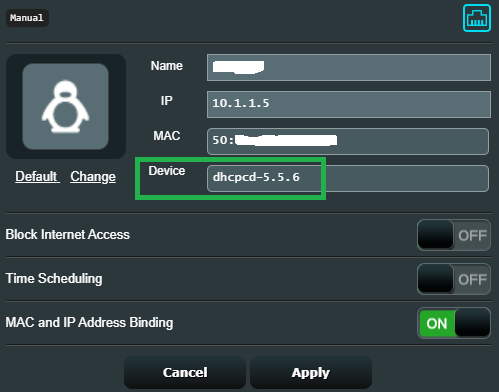

    Some device names (samsung smart phone) are a bit flawed (beta fw 9.0.0.4_388_20987)
    dhcpcd-5.5.6
    android-dhcp-8.0.0
    #21124
    • Replies 8,724
    [quote quote=21120]Some device names (samsung smart phone) are a bit flawed (beta fw 9.0.0.4_388_20987)[/quote]
    I will let ASUS know

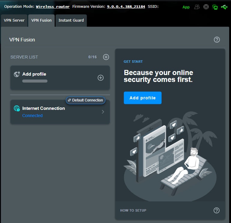

    Hi;
    Does the update include VPN Fusion?
    #21137
    • Replies 8,724
    [quote quote=21136]Does the update include VPN Fusion?[/quote]
    Hopefully one of the other forum members can confirm, but I believe VPN Fusion is included.
    #21138
    Black Bird
    • Replies 146
    [quote quote=21136]Hi; Does the update include VPN Fusion?[/quote]
    like the previous beta
    #21144
    AvatarEl3rt1cal
    • Replies 33
    [quote quote=21138]
    like the previous beta[/quote]
    Thanks, both Fusion and stability adjustment seem to be working as expected. Be interested to see if long uptimes (5 months plus) still kill off traffic monitor as they did with 3.0.0.4.386_45660 for me. (my last update as fusion got removed subsequently)
