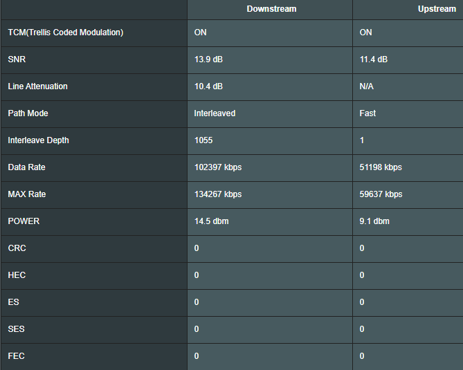

I don’t want to restart but the power cut is not up to me :) So I wanted to save the telnet changes.
December 3, 2019 at 9:57 pm in reply to: ASUS – DSL-AC88U / DSL-AC3100 Firmwares (beta's) etc. Looks like a new Beta Release for the DSL-AC88U is available, this version has Telnet enabled and improved 2.4GHz wifi (I believe). DSL-AC88U_v9.10.06_build581_debug.w.zip https://www.asuswebstorage.com/navigate/s/604D61534F2541D1B3CE1CC031A697E4Y UK Sentinel In a completely... #5193then it gives the result
/ # bcm_xdslctl profile –save
bcm_xdslctl –save is only supported from Linux404 on ward
December 2, 2019 at 7:39 pm in reply to: ASUS – DSL-AC88U / DSL-AC3100 Firmwares (beta's) etc. Looks like a new Beta Release for the DSL-AC88U is available, this version has Telnet enabled and improved 2.4GHz wifi (I believe). DSL-AC88U_v9.10.06_build581_debug.w.zip https://www.asuswebstorage.com/navigate/s/604D61534F2541D1B3CE1CC031A697E4Y UK Sentinel In a completely... #5175December 2, 2019 at 7:15 pm in reply to: ASUS – DSL-AC88U / DSL-AC3100 Firmwares (beta's) etc. Looks like a new Beta Release for the DSL-AC88U is available, this version has Telnet enabled and improved 2.4GHz wifi (I believe). DSL-AC88U_v9.10.06_build581_debug.w.zip https://www.asuswebstorage.com/navigate/s/604D61534F2541D1B3CE1CC031A697E4Y UK Sentinel In a completely... #5173Connection type VDSL 17a
Connection speed is 100/60
To prevent CRC errors, I limit the upload speed to 50 Mbps using telnet. When I enter the code with Telnet, everything works exactly the way I want it, but I don’t know the telnet code to store the settings.You need to login in order to vote
December 2, 2019 at 6:37 pm in reply to: ASUS – DSL-AC88U / DSL-AC3100 Firmwares (beta's) etc. Looks like a new Beta Release for the DSL-AC88U is available, this version has Telnet enabled and improved 2.4GHz wifi (I believe). DSL-AC88U_v9.10.06_build581_debug.w.zip https://www.asuswebstorage.com/navigate/s/604D61534F2541D1B3CE1CC031A697E4Y UK Sentinel In a completely... #5168Telnet is enabled by default
I did speed limitation with telnet and I use it like this
bcm_xdslctl configure –maxDataRate 102400 51200 524280
This setting is cleared when restarted. Is there anything I can do to store telnet settings?
