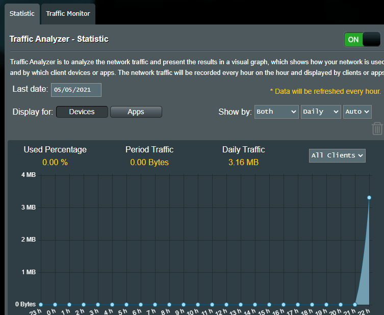

Yes, when I shut down AiProtection, I followed it for a while, the usage rate remained at 60%. When I activate it again later, the RAM usage increases
only AiProtection is active

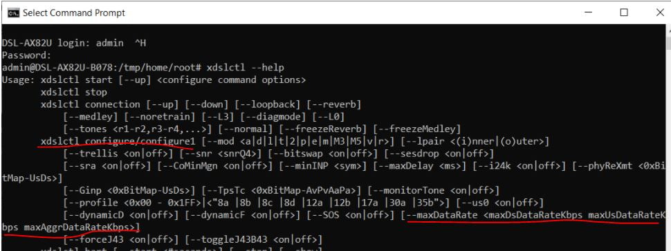

Will this command be functional over telnet?
bcm_xdslctl configure –maxDataRate 102400 57599 524280
