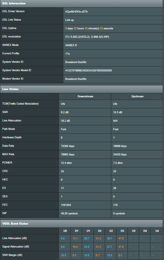

Today swapped the ISP provided ADSL cable to a CAT6 one. After over 6 hours connection no CRC or ES errors downstream. Hoping it stays like this.

Are these error counts acceptable for VDSL2?

November 18, 2018 at 11:55 am in reply to: ASUS – DSL-AC88U / DSL-AC3100 Firmwares (beta's) etc. Looks like a new Beta Release for the DSL-AC88U is available, this version has Telnet enabled and improved 2.4GHz wifi (I believe). DSL-AC88U_v9.10.06_build581_debug.w.zip https://www.asuswebstorage.com/navigate/s/604D61534F2541D1B3CE1CC031A697E4Y UK Sentinel #1529[quote quote=1528]This is interesting as I also noticed my SNR value was higher than norm, around 10, but I assumed it was due to a lot of testing I was doing at the time, ASUS DSL-AC88U Firmware version 1.10.06-Build585 did have a driver update ad whether the value are being reported incorrectly is another option? Hopefully others can say also if they have noticed similar reading[/quote]

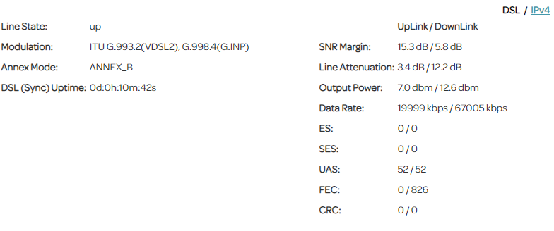

I thought the upstream SNR had gone from 15dB to 7dB due to the cold weather. But it was actually due to firmware change. With beta585 (and the HG633) the upstream SNR is 15dB but with official 585 and beta586 it is reported as 7dB.
Could that have stopped DLM from reducing downstream SNR target? All other line stats were virtually identical with the different firmware.
November 18, 2018 at 7:29 am in reply to: ASUS – DSL-AC88U / DSL-AC3100 Firmwares (beta's) etc. Looks like a new Beta Release for the DSL-AC88U is available, this version has Telnet enabled and improved 2.4GHz wifi (I believe). DSL-AC88U_v9.10.06_build581_debug.w.zip https://www.asuswebstorage.com/navigate/s/604D61534F2541D1B3CE1CC031A697E4Y UK Sentinel #1523There is something wrong with the official build585 and beta build586. I had a full DLM reset on 07/11/18. With those 2 builds DLM refused to reduce my SNR from 6dB to 5dB.
I then decided to revert to beta build585 late last night on 17/11/2018 (just to experiment). Within 6 hours DLM kicked in and reduced SNR to 5dB. Stats attached.
The only difference I noticed was upstream SNR is higher on beta585 than the other 2 firmware.
