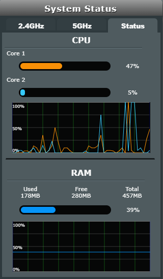

November 24, 2018 at 6:55 pm in reply to: ASUS – DSL-AC88U / DSL-AC3100 Firmwares (beta's) etc. Looks like a new Beta Release for the DSL-AC88U is available, this version has Telnet enabled and improved 2.4GHz wifi (I believe). DSL-AC88U_v9.10.06_build581_debug.w.zip https://www.asuswebstorage.com/navigate/s/604D61534F2541D1B3CE1CC031A697E4Y UK Sentinel In a completely... #1612As an example, my RAM usage stats look like this with AiProtection off.
I always flash firmware twice with a factory reset each time. I do get spikes in CPU usage.

November 22, 2018 at 8:44 pm in reply to: ASUS – DSL-AC88U / DSL-AC3100 Firmwares (beta's) etc. Looks like a new Beta Release for the DSL-AC88U is available, this version has Telnet enabled and improved 2.4GHz wifi (I believe). DSL-AC88U_v9.10.06_build581_debug.w.zip https://www.asuswebstorage.com/navigate/s/604D61534F2541D1B3CE1CC031A697E4Y UK Sentinel In a completely... #1593How is everyone’s memory usage? I’m on the stock 585 and not using AI. It seems like RAM usage is increasing 1-2% each day. Currently on day 12, and 260MB used (57%). At this rate, will I be out of memory in 43 days time?
I am on beta585 and don’t have any RAM usage problem. I do no use AI as everyone seems to find it buggy. Sitting on 180MB used for 3 days now.

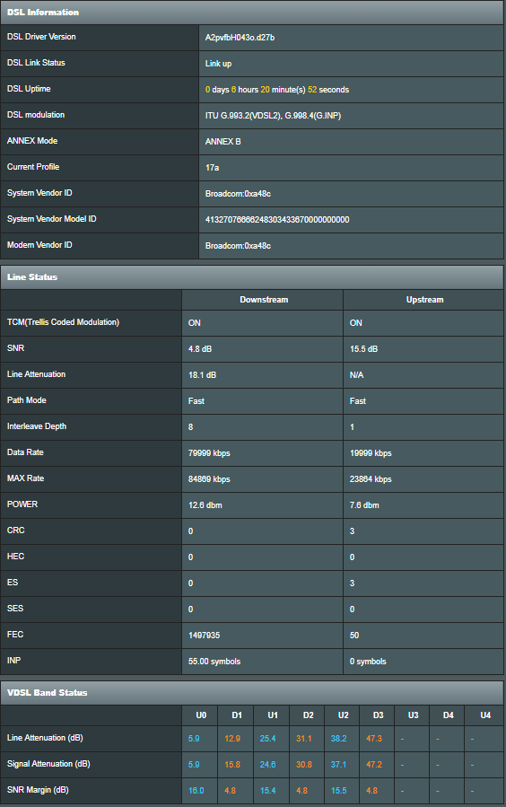

November 21, 2018 at 12:33 am in reply to: ASUS – DSL-AC88U / DSL-AC3100 Firmwares (beta's) etc. Looks like a new Beta Release for the DSL-AC88U is available, this version has Telnet enabled and improved 2.4GHz wifi (I believe). DSL-AC88U_v9.10.06_build581_debug.w.zip https://www.asuswebstorage.com/navigate/s/604D61534F2541D1B3CE1CC031A697E4Y UK Sentinel In a completely... #1564It is the CRC that you need to keep an eye on, just incase there is to much noise on the line, yours stats are fine at moment, but keep an eye on CRC/s and if the rate per day increases etc.
Thanks, I will keep an eye on the CRC and ES errors. What level is considered normal?
November 20, 2018 at 7:09 pm in reply to: ASUS – DSL-AC88U / DSL-AC3100 Firmwares (beta's) etc. Looks like a new Beta Release for the DSL-AC88U is available, this version has Telnet enabled and improved 2.4GHz wifi (I believe). DSL-AC88U_v9.10.06_build581_debug.w.zip https://www.asuswebstorage.com/navigate/s/604D61534F2541D1B3CE1CC031A697E4Y UK Sentinel In a completely... #1561I am back on beta585. DLM has now given me full sync speed with a bit of room to Max rate. Surprising as it’s been freezing cold for the past 2-3 days.
Are these error counts acceptable for VDSL2?

November 18, 2018 at 2:19 pm in reply to: ASUS – DSL-AC88U / DSL-AC3100 Firmwares (beta's) etc. Looks like a new Beta Release for the DSL-AC88U is available, this version has Telnet enabled and improved 2.4GHz wifi (I believe). DSL-AC88U_v9.10.06_build581_debug.w.zip https://www.asuswebstorage.com/navigate/s/604D61534F2541D1B3CE1CC031A697E4Y UK Sentinel In a completely... #1536I would have thought so, as SNR value that high, the DSLAM/Exchange may think it will would require at BT OPENREACH visit, so goes into default mode, or stays the same etc. Best to SEND ASUS a Feedback form if you are running Official Firmware, let them know about latest bug, mention UK Sentinel at beginning and I will drop them an email also asking them to keep an eye out for your feedback
I have sent feedback and mentioned your name. Will revert back to beta585 which has been most stable for me so far.
