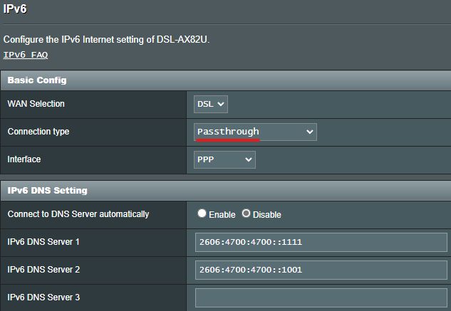

Did this firmware release fix your IPv6 issues
The problem persists, it only works properly with the “passthrough” option.
